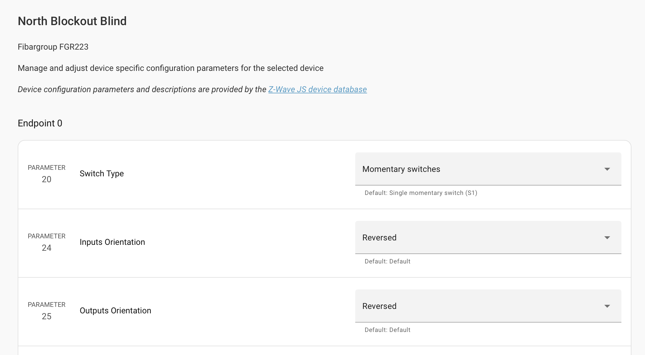

It‘s FGR-223 or FGR-222?
Because for the FGR-223 you can change the Input and Output orientation via Parameter (24 & 25)

I was able to invert my FGR-223 using the Zwave configuration panel which was released in the latest home assistant version.

I had this problem. I set both of these to reversed and it seems the buttons on the wall do the right thing and home assistant knows the right way up.
