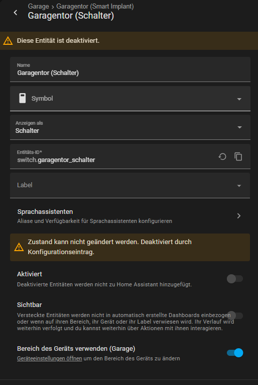

However, I just recongized, that my Fibaro Smart Implant does not show the two output switches.
In the integration these are deactivated and I cannot activate them from the integration (it says: "Condition cannot be changed. Deactivated by config entry).
Because I did not change this, I assume ZWAVE JS UI did.

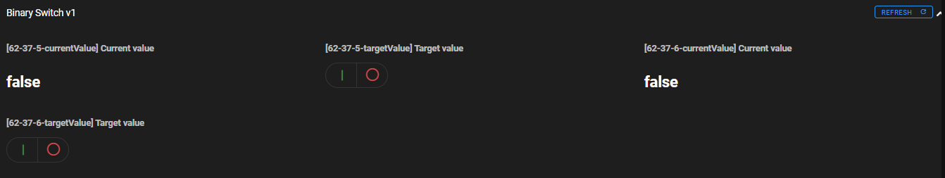

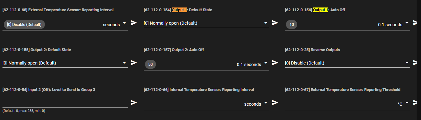

I am not familiar with ZWAVE JS UI yet, but in the Node I can see nothing obvious:
Interestingly there is a similar post on the forum about swapping Zigbee integrations and a device had the same error message because it was associated with the previous Zigbee integration. It may be possible that the entries are somehow still tied to your previous Zwave JS add-on configuration. You’d have to investigate in the .storage folder to be sure, and I’m not sure how comfortable you are with that.

I found this in core.entity_registry
"disabled_by":"config_entry","entity_category":null,"entity_id":"switch.garagentor_schalter","hidden_by":null
