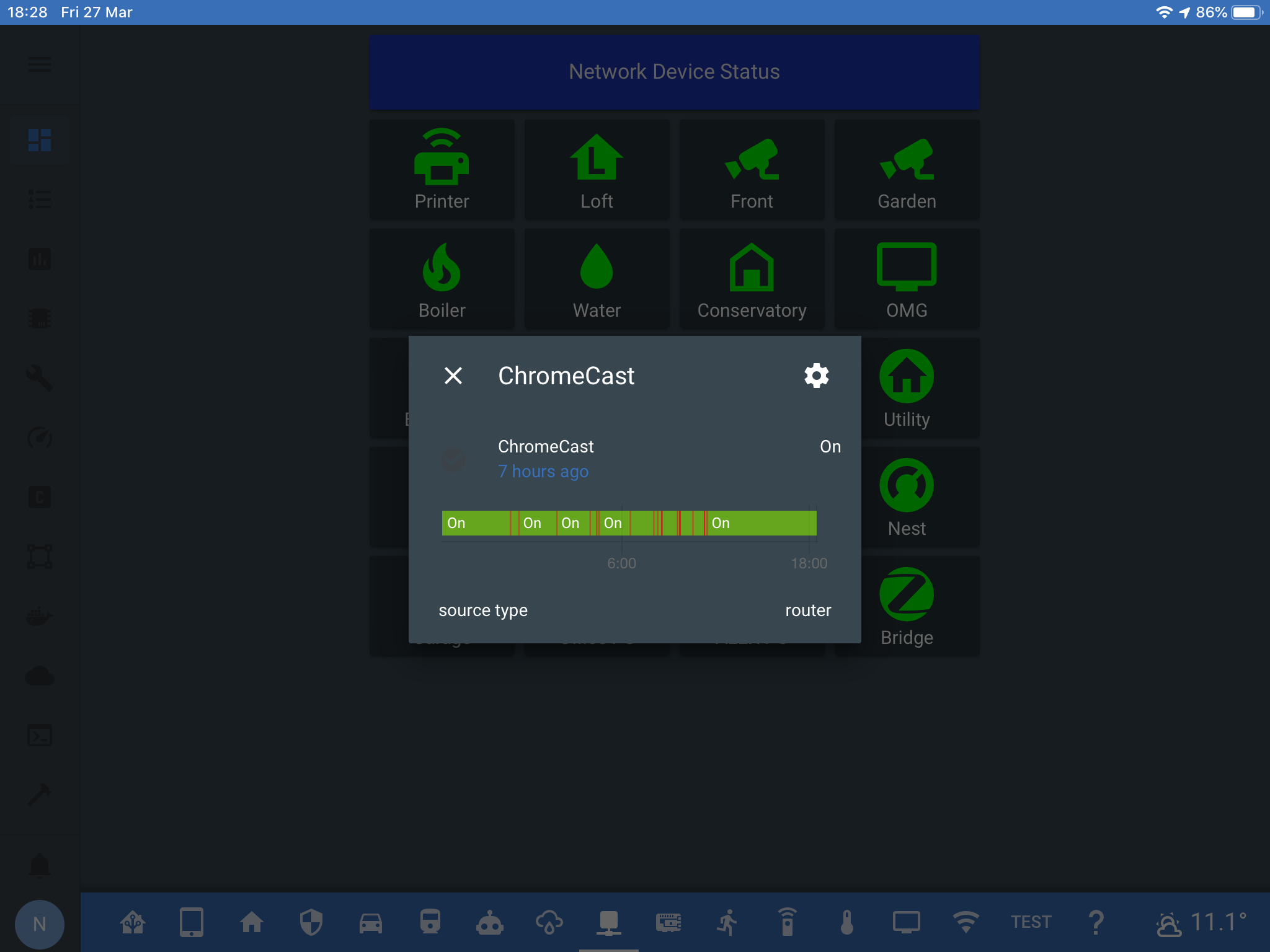

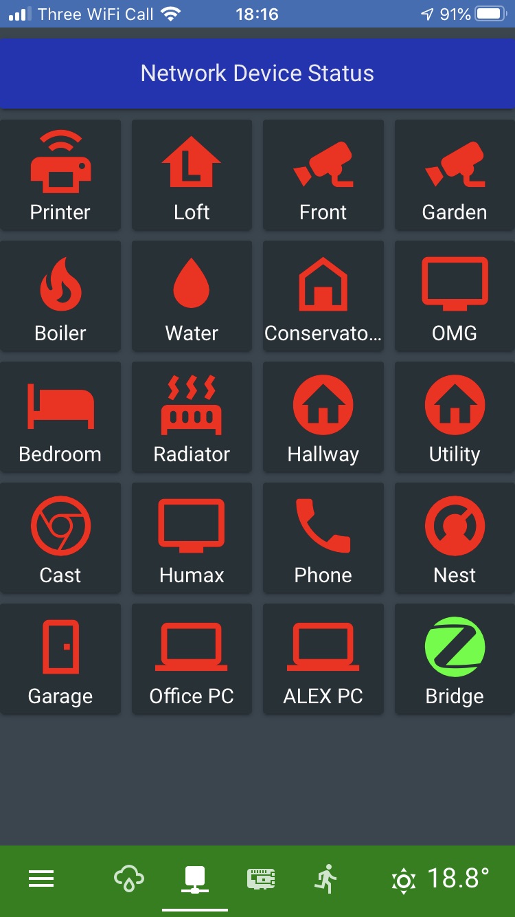

Since the update to 0.107.6 last night my all my device tracker devices go offline after about 30 minutes or so. If I rollback to 0.107.5 they work as expected.
I get the same Device Tracker error in the logs for both 0.107.5 & 0.107.6. This is only affecting normal ethernet tracking via my router as Bluetooth tracking still works.

Just woke up after nights and mine has failed again. Might roll back and stay at 0.107.5 for the moment

Afraid to say that this did not fix it - it could go 12+ hours before failing or a few hours - it is very random and annoying.

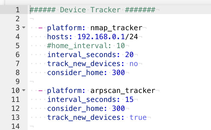

Hi - I have been having the same problem. I read on the Person integration about the clashes that can happen so I removed all persons and # out the person from config. I then stripped all the known devices apart from the house mobile phones. I then reloaded persons from the services and rebooted.
I have two nmap scanners running both are set with the scheduled scan interval 0:00:20. On reboot it showed in the error log as having 2 sets one with the default 12 and the other 20 which repeated. After 40 mins it settled down to showing both 20.
I have also noticed the known_devices has changed in the descriptions of the devices. Everything appears to be running showing "ā€˜home’ that I want to except the error log of ā€˜Updating device list from legacy took longer than the scheduled scan interval’
Just thought I’d share the observations if it helps anyone.
