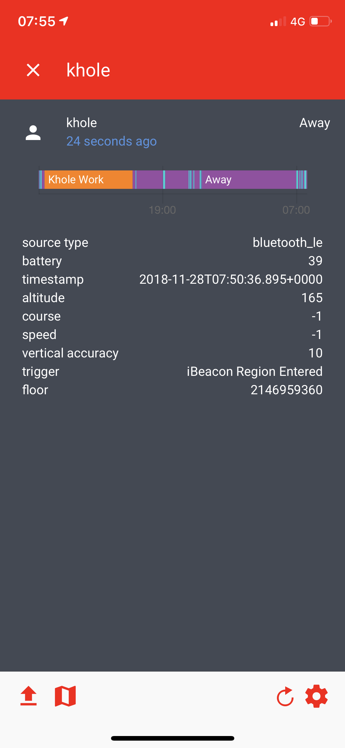

iBeacon seems to have gone very strange with build (27) it advises I have just entered my a region via iBeacon and I only have 1 beacon setup which is in my home. Even though it advises I have entered a region via beacon the status advises I am away when I am at home
