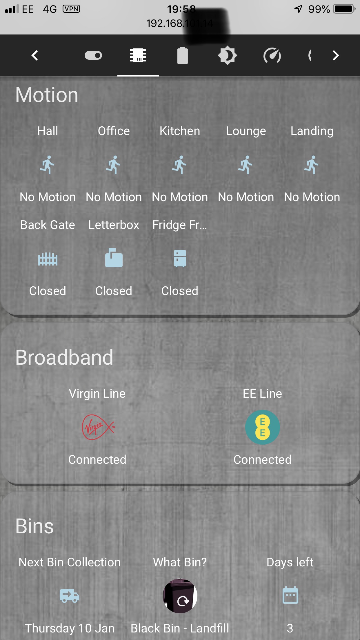

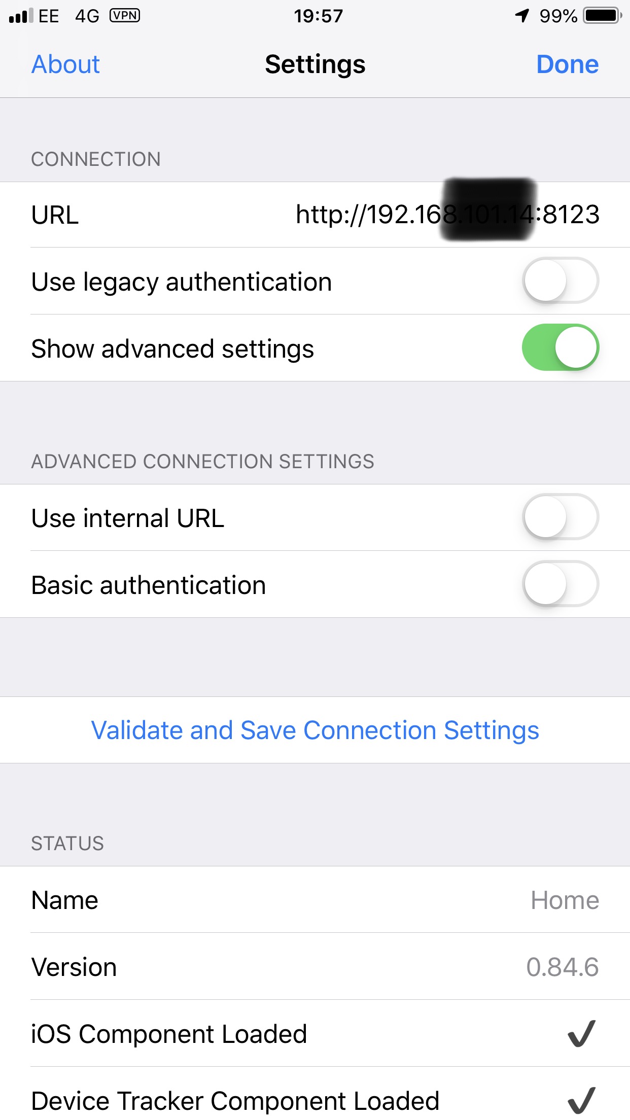

My HA (not hass.io) 0.84.6 is not exposed to the internet in anyway. I connect to it externally via a VPN to my router on my iPhone. The webpage works great through the VPN, but the iOS app won’t connect at all. Is this by design?

What are you using for the connection URL? Is it the internal IP address of your HA server?
If you’re using a hostname, that might not resolve over the VPN. Try using the IP address while connected to the VPN.
Tried a couple of things - IP address in external, internal and both and even put a DNS forwarder on LAN of MarkHA.co.uk that works internally and externally on the webpage in safari, but not in the app.
Don’t do the ā€œuse internal URLā€ setting. Just use the 192.168.x.x. address of your internal server.
Same :frowning:
I think there must be something in the app that ignores the VPN and uses the cellular connection?
It can’t ignore the VPN :slight_smile: That would defeat the whole purpose of the VPN.
So that exact same URL works when you are on your home net? And that exact same URL works over VPN via your browser via the VPN?
Edit: You don’t need to obscure the 192.168.x.x addresses - they are private, no routable addresses usable from your LAN behind your router only.
