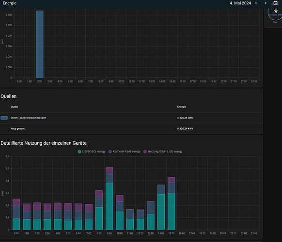

Anybody else having strange effects in the energy dashboard since 2024.5?
I have a shelly 3EM and have a helper for it to sum up the three “energy” entities for the dashboard. Additionally I have those three entities separately in the “detailed usage of specific devices” section.
That worked flawlessly from the start some months ago.
But since two days (likely since ugrading to 2024.5(.1)) the general view doesn’t show any hourly values anymore, but only one entry at 2-3 o’clock with the total amount of the counter (a few thousand kwh), instead of just the amount of the increase of the counter within that hour. The detailed view on the other hand still shows hourly values for the three counters over the whole day, just with the change for each hour.
Anybody else with that behaviour? Or any clue what’s happening?
added a screenshot to maybe better show what I described above:

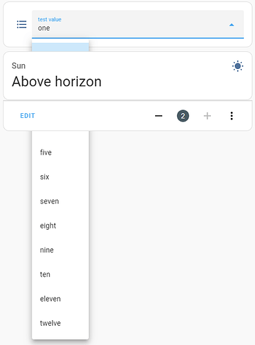

Some theme-related changes were added in 2024.5 - and using variables in a custom theme may break Z-index.
No idea how using a “filter” var may affect this.
type: vertical-stack
  - type: entities
      - input_select.test_value
  - type: entity
    entity: sun.sun
Theme:
theme3:
  ha-card-backdrop-filter: blur(5px)
Issue
