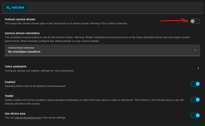

For everyone experiencing increased CPU usage after updating to Home Assistant 2026.8.x and using the Generic Camera integration, try this:
Disable “Preload camera stream” on all your Generic Camera entities and check whether the CPU usage returns to normal.
In my case, this solved the problem. CPU usage goes back to normal when “Preload camera stream” is disabled.
This does not happen with 2026.7.4, so it may be related to a bug introduced in the 2026.8.x releases.
If you are experiencing this issue, it is worth testing before troubleshooting anything else.

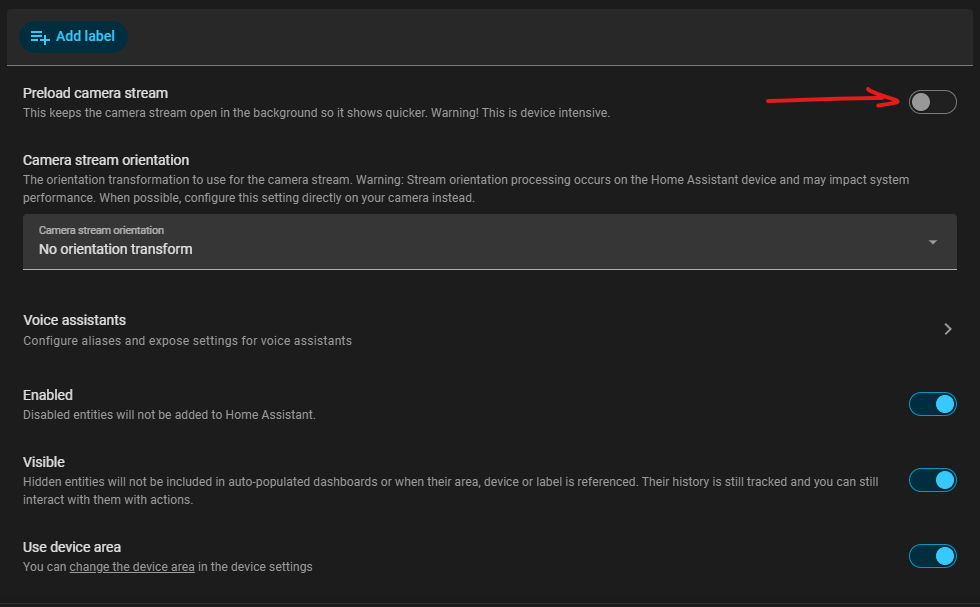

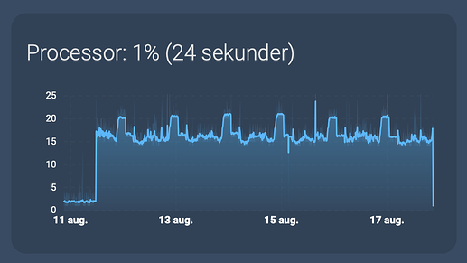

I gave this another try and it turned out that one of my 6 Unifi cameras had the preload active, not sure what difference it makes because with my use pattern I have never noticed a difference.
This fixed my CPU instantly and now I have even lower CPU compared to before August 11th when I updated to 2026.8.
Thank you for mentioning this and giving me a reason to have a look at it again :slight_smile:
