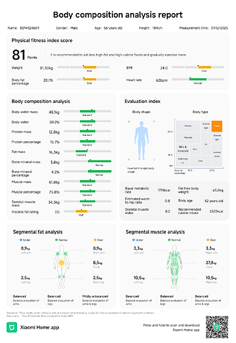

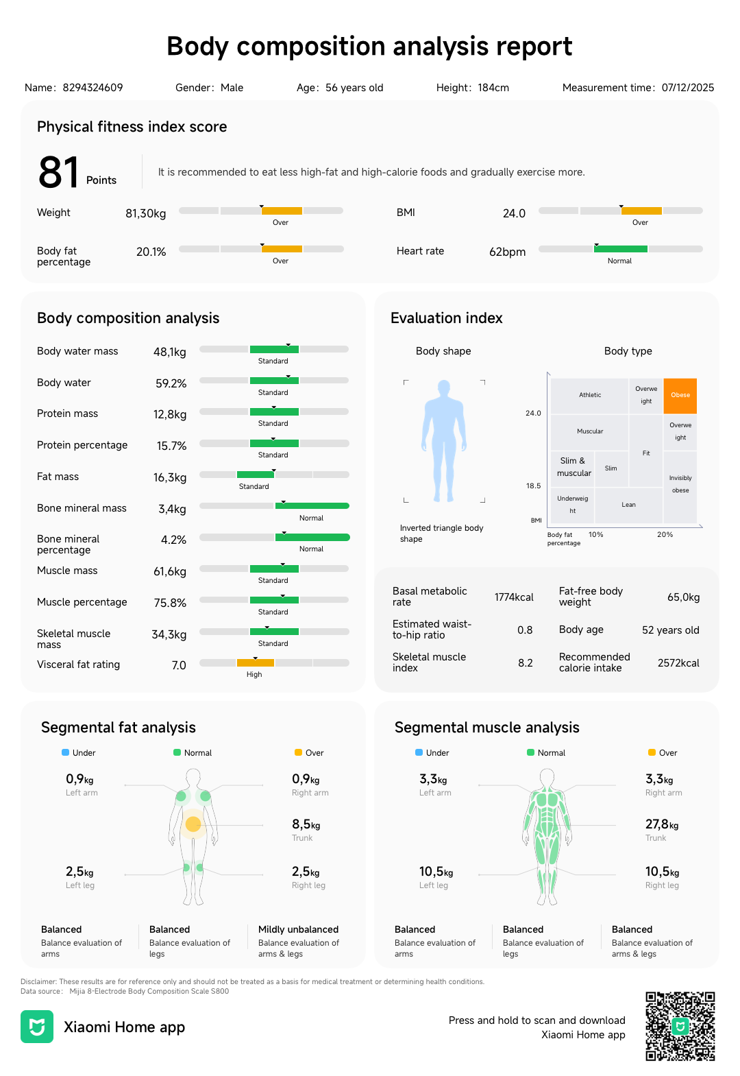

This is how the Mija S800 Body Composition Report looks like in the Xiaomi App:
Would’t it be great if there were a Home Assistant Dashboard that mimics the Xiaomi Report.

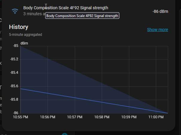

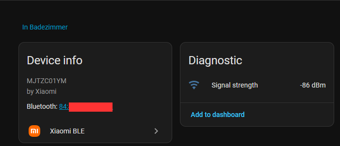

This is super confusing. It says that is supporting it, but pairing seems to need a special way on how to.
Signal strength seems to update
But no other entity though.

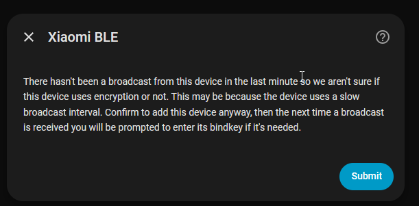

I think it has something to do with with initial pairing, since it seems to say:
i couldnt really find it but ill show it and IF i you are cool ill allow more
this is super misleading and I dont like these kind of messages since I really dont know what to do to make it pair properly.
