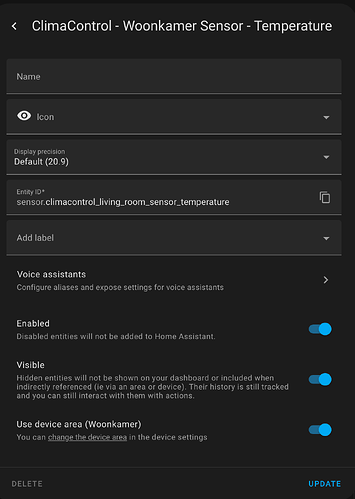

Oke, the HVAC has an external temp sensor as shown in the screenshot to avoid allot of cycling of the HVAC.
So would I need to set the temp sensor somewhere in the automation?

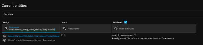

Could you check in the developer option if your thermostat owns the device class temperature?
It does not :frowning: something for the sensor dev? active here as well on the forum
Yes, that’s the right way. If I open this selector for all sensors I will get a flood of support requests. xD
//EDIT: but you can navigate to line 627 in the blueprint or search for input_temperature_sensor (line 609) and delete following as a workaround. Don’t forget to reload your automations.
