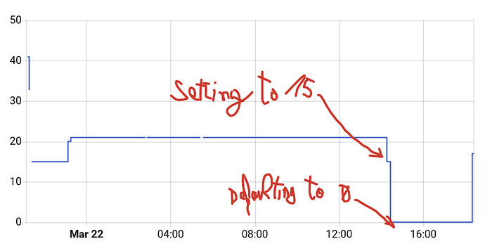

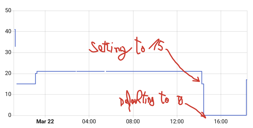

I am struggling with an Ariston Genus One boiler.
I have automatized all heating but when heating require only heating small part of the house the power of the boiler needs to be reduced because otherwise the returning water from radiators will be too hot and boiler will immediately stop heating and start recirculating.
I can adjust the boiler power from boiler menu,
2.3.1 Maximum heating power
2.3.4 Maximum percentage heating power
which resolves the problem. Right now I set up HA to alert me when too many recirculations are triggered and I reduce the boiler power from the menu but I can’t keep doing so all the time. I want to control this parameter from HA.
I could not identify the 2.3.1 parameter in ebus.
I did find the 2.3.4 parameter which I can read with below config in the ebusd csv file:
 r,genusone,heat_max_power_pct,Heating Bolier Max Power PCT,,3c,2000,6329,,s,IGN:1,,,,,s,UCH,,pct,,,,,,,,,,,,,,,,,,,,,,,,,,,,,,
I tried to write a new value so that ia can change the heating power from HA using the following lines but none of them, could sucsessfully change the value in the boiler:
w,genusone,heat_max_power_pct,Heating Boiler Max Power PCT,,fe,2020,6329,,s,UCH,,pct
w,genusone,heat_max_power_pct,Heating Bolier Max Power PCT,,fe,2020,6329,,s,UCH,,,pct
w,genusone,heat_max_power_pct,Heating Bolier Max Power PCT(Write),,3c,2020,6329,,s,UCH,,,pct
w,genusone,heat_max_power_pct,Heating Boiler Max Power PCT (Write),,3c,2020,6329,,s,IGN:1,,,,,s,UCH,,pct
w,genusone,heat_max_power_pct,Heating Boiler Max Power PCT (Write),,3c,2020,6329,,s,IGN:1,,,,,s,UCH,*,pct,,,,,,,,,,,,,,,,,,,,,,,,,,,,,,**
I hope with help from the community we can make the 2.3.4 and 2.3.1 parameters read/writable as they are very important for making proper automations with ebusd.
I can try and test on my boiler If you have any suggestions because I am out of ideas.
EDIT: the 2020 PBSB is correct, you may need to change the writing parameter as master “m” instead of slave “s”
Try this:
w,genusone,heat_max_power_pct,Heating Bolier Max Power PCT,,3c,2020,6329,,m,UCH,,,
and/or this
w,genusone,heat_max_adj_power_pct,Heating Bolier Max Adjustable Power PCT,,3c,2020,6629,,m,UCH,,,
Beware that the internal flash memory of the boiler PCB is not meant to be written continuously, in normal circumstances you set the thing once and then leave it almost untouched for months.
If you write many times a day to change some setting you may, in the long run, damage your PCB flash module needing to change the entire PCB.
Thank you. I have tried the following:
w,genusone,heat_max_power_pct,Heating Bolier Max Power PCT(Write),,3c,2020,6329,,m,UCH,,,pct
and
But if I set from HA the numeric value, let’s say to 15 and then go to the boiler menu, the values are 0 on the boiler. Same happens for both parameters. Somehow the values are not sent correctly and the boiler defaults them to 0.
Regarding the frequent parameter change in boiler. Isn’t the Sensys or AristonNet ebus thermostat doing the same thing? The original Thermostat is continually adjusting the parameters based on outside temperature, inside temp, returning water temp, outgoing water temperature, day, night scheduler, leaving/returning home, scheduler and so on.
OK I got it fixed, the problem didn’t lay on the format of the writing line, it was the datatype, you need to change UCH to UIN, it matters because UCH is a single byte datatype while UIN is 2 bytes. While reading a percentage it doesn’t matter but when you try to write you’re missing a piece.
these are the correct lines, you may want to change also the others, I’ll fix my repo asap…
r,genusone,heat_max_power_pct,Heating Bolier Max Power PCT,,3c,2000,6329,ign,s,IGN:1,,,,,s,UIN,,pct
w,genusone,heat_max_power_pct,Heating Bolier Max Power PCT,,3c,2020,6329,,m,UIN,,,
AFAIK if you use weather compensation the boiler built in logic did not change the MAX power settings, the boiler change the LWT setpoint which is probably stored in RAM so no flash burning. The internal logic then adapt the CURRENT power setting to align the LWT to the setpoint.
You are hijacking the MAX power setting to do a similar thing “capping” the boiler power by other means.
I suggest you to buy an external probe (and an internal bus enabled thermostat) to accomplish your goals, you’ll spens 100/150€ once but you’ll get a more robust systems…

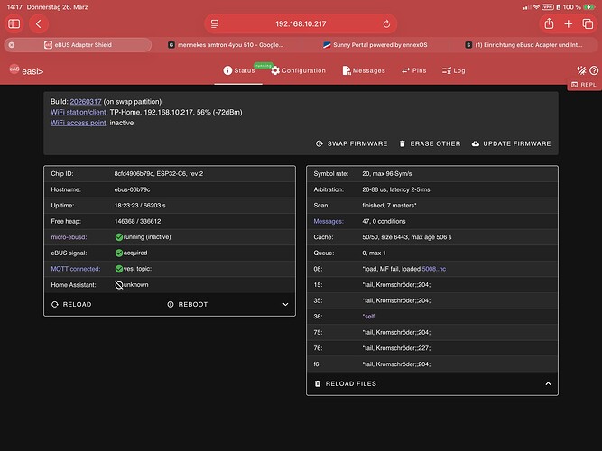

I am still at a very early stage with ebusd. The adapter is connected to the heating system and is active. Data is also being received, as I can see this in the log.
a { text-decoration: none; color: #464feb; } tr th, tr td { border: 1px solid #e6e6e6; } tr th { background-color: #f5f5f5; }
I suspect that my configuration on the Home Assistant (HA) side is not set up correctly. Unfortunately, I can’t find any further information on this when using micro ebusd.
Does anyone here have a tip for me?
[14:07:19] INFO: eBUSd addon version 26.1.6
[14:07:19] INFO: ebusd --foreground --updatecheck=off --mqtthost=core-mosquitto --mqttport=1883 --mqttuser=<redacted> --mqttpass=<redacted> --mqttjson --mqttint=/config/mqtt-hassio.cfg --device=ens:192.168.10.217:9999 --configpath=https://ebus.github.io/next --scanconfig --latency=10000 --pollinterval=5 --mqttvar=filter-direction=r|u|w --mqttvar=filter-name= --scanretries=5
2026-03-26 14:07:19.951 [device error] transport closed
2026-03-26 14:07:19.951 [bus error] unable to open 192.168.10.217:9999: ERR: generic I/O error
2026-03-26 14:07:19.954 [main notice] ebusd 26.1.26.1 started with broadcast scan on device: 192.168.10.217:9999, TCP, enhanced
2026-03-26 14:07:20.184 [bus notice] bus started with own address 31/36
2026-03-26 14:07:20.184 [bus notice] device invalid
2026-03-26 14:07:20.268 [mqtt notice] connection established
2026-03-26 14:07:25.192 [device error] transport closed
2026-03-26 14:07:25.192 [bus error] unable to open 192.168.10.217:9999: ERR: generic I/O error
2026-03-26 14:07:25.193 [bus notice] device invalid
2026-03-26 14:07:30.203 [device error] transport closed
2026-03-26 14:07:30.203 [bus error] unable to open 192.168.10.217:9999: ERR: generic I/O error
2026-03-26 14:07:30.203 [bus notice] device invalid
2026-03-26 14:07:35.206 [device error] transport closed
2026-03-26 14:07:35.206 [bus error] unable to open 192.168.10.217:9999: ERR: generic I/O error
2026-03-26 14:07:35.206 [bus notice] device invalid
2026-03-26 14:07:40.211 [device error] transport closed
2026-03-26 14:07:40.211 [bus error] unable to open 192.168.10.217:9999: ERR: generic I/O error
2026-03-26 14:07:40.211 [bus notice] device invalid
2026-03-26 14:07:45.218 [device error] transport closed
2026-03-26 14:07:45.218 [bus error] unable to open 192.168.10.217:9999: ERR: generic I/O error
2026-03-26 14:07:45.218 [bus notice] device invalid
2026-03-26 14:07:50.222 [device error] transport closed
2026-03-26 14:07:50.222 [bus error] unable to open 192.168.10.217:9999: ERR: generic I/O error
2026-03-26 14:07:50.222 [bus notice] device invalid
2026-03-26 14:07:55.226 [device error] transport closed
2026-03-26 14:07:55.226 [bus error] unable to open 192.168.10.217:9999: ERR: generic I/O error
