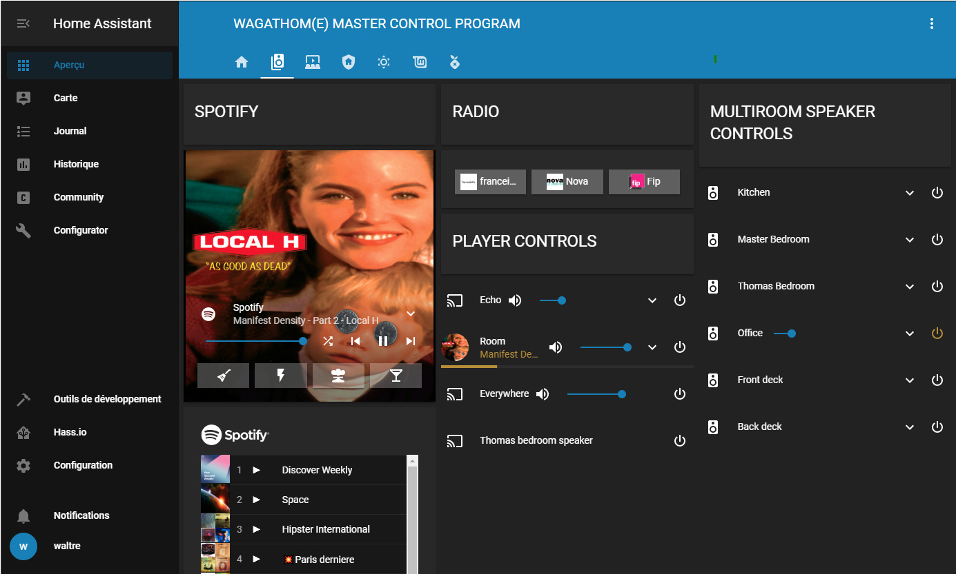

hello @waltre, i opened a post about integrating russound with my knx system.
Maybe you can help me.
https://community.home-assistant.io/t/integrate-knx-russound/194343/8
i am not able to display all zones in the same ‘card’. I tryed to instal Mini Media Player, but not working because of entity id.
and also, not able to create rules.
i am blocked with entity ID
I also tryied to create a group
media_player_Russound:
entities:
- media_player.Russound.Etage.Mezzanine
- media_player.Russound.Etage.SDB
- media_player.Russound.RDC.Cuisine
- media_player.Russound.RDC.Salle_à_manger
- media_player.Russound.RDC.Salon
- media_player.Russound.RDC.SDB
but getting error while checking configuration
Invalid config for [group]: Entity ID media_player.Russound.Etage.Mezzanine is an invalid entity id for dictionary value @ data['group']['media_player_Russound']['entities']. Got ['media_player.Russound.Etage.Mezzanine', ...
tks for your help.
I guess you have 2 questions:
How to put all the zones in one card?
How to get rid of the error message on the Russound media_player entities?
1- card setup
here is my config to put all the zones on 1 card - my goal was to only be able to turn on/off and be able to chose the source:
cards:
- content: ' '
title: MULTIROOM SPEAKER CONTROLS
type: markdown
- entity: media_player.kitchen
group: true
hide:
controls: true
icon_state: false
power_state: false
source: false
type: 'custom:mini-media-player'
- entity: media_player.master_bedroom
group: true
hide:
controls: true
icon_state: false
power_state: false
source: false
- entity: media_player.thomas_bedroom
group: true
hide:
controls: true
icon_state: false
power_state: false
source: false
- entity: media_player.office
group: true
hide:
controls: true
icon_state: false
power_state: false
source: false
- entity: media_player.front_deck
group: true
hide:
controls: true
icon_state: false
power_state: false
source: false
- entity: media_player.back_deck
group: true
hide:
controls: true
icon_state: false
power_state: false
source: false
- entity: media_player.master_bathroom
group: true
hide:
controls: true
icon_state: false
power_state: false
source: true
state_color: true
type: vertical-stack
then this is what I get:
2 - For the error message
- it seems like you’ve got a solution on the other thread by replacing the ‘.’ by ‘_’ for naming the media_player entities
W.
you saved me !!! tks a lot.
