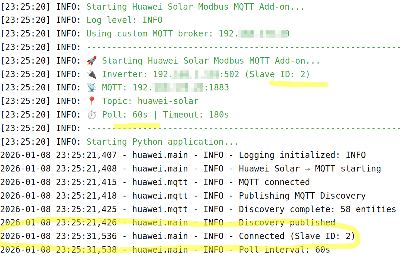

Hi @arboeh,
I found your add-on while trying to figure out a way that my Huawei inverter starts to speak home assistant.
I like the idea to do it via MQTT (I have a separate MQTT instance running) etc.
I tried to set up, but it runs into timeouts (v1.4.2)
But nevertheless, although I am not sure, it connects to MQTT just fine (and the 50+ entities become available in HA) :+1:.
And it also connects to the inverter (via the dongle) fine, but only initially and does not produce any data at all.
Instead, it runs into a timeout right away. At least it is what it seems to me.
But I might got it wrong here. Or what does it mean,
2026-01-08 23:25:31,536 - huawei.main - INFO - Connected (Slave ID: 2)
But five seconds, the following happens each time:
> 2026-01-08 23:25:36,545 - huawei_solar.huawei_solar - ERROR - Timeout while waiting for connection. Reconnecting

Any idea? Any suggestion?
It runs on the laetest HA OS.
Firmware etc.:
Dongle V200R022C10SPC312
Inverter (20KTL-M2) V100R001C00SPC173
HA OS 2026.1
Thanks,
HANT
PS. Other solutions seem to suffer the same fate.
Hi @HANT,
This looks like a connection lock timeout issue – the initial Modbus connection works, but the register reads take too long and hit the timeout.
First: Which add-on version are you using? Version info will be added to the logs soon. Also, did you already try with log level DEBUG?
Quick things to try:
  1. Change Slave ID (most likely fix)
    Your Slave ID: 2 is unusual. Please try 1 (standard), 0, or 16.
  2. Check network connection
    • Is the inverter on stable LAN or via SDongle/Wi-Fi?

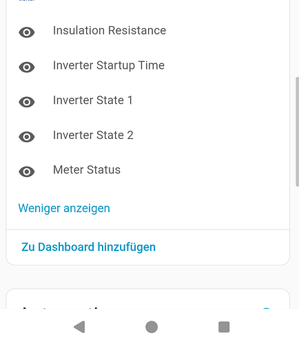

While I am happy now, I added a feature request to your repository.
I would love to see the insulation resistance (MΩ) being reported as well.
I think it makes sense to have when you see it degrading hard over time, it indicates some problem w/ the DC wiring incoming. Or it helps if the PV production declines to narrow down the issue.

The insulation resistance shouldn’t be a problem. I think I just need to add one more register, that’s all.

And “your” value is there already. It’s disabled per default.
Thanks, I thought I checked it. Nevertheless I found it alright
