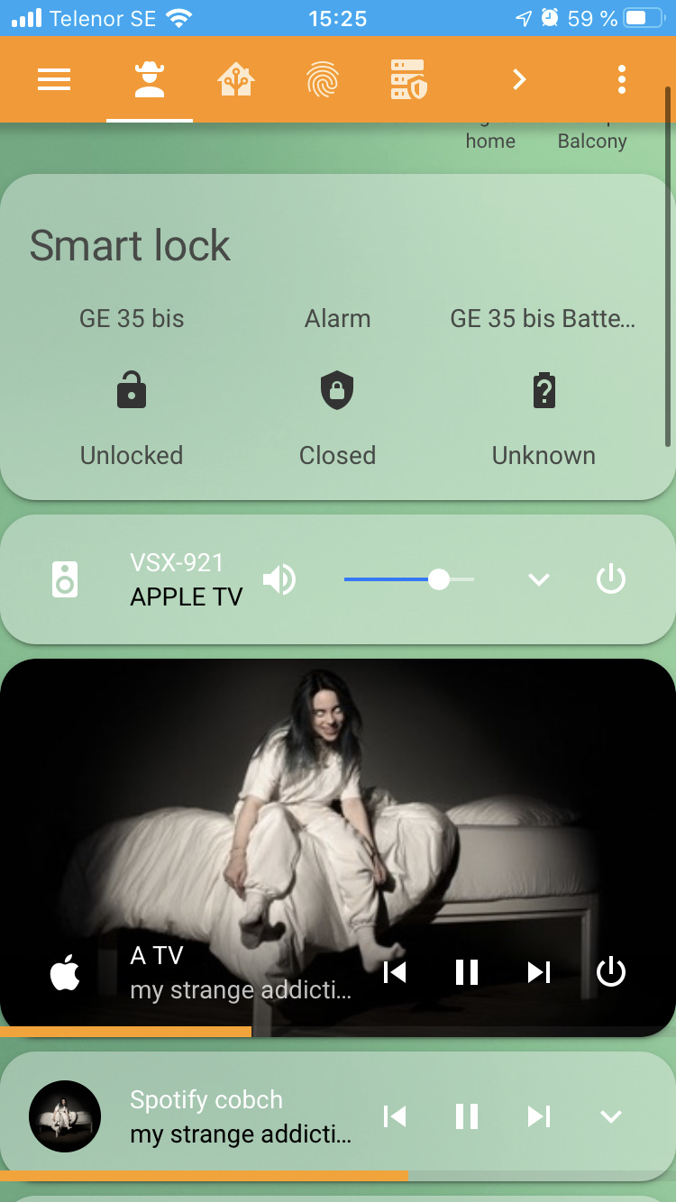

I still do not manage to make the artwork working when I stream a media (Spotify or whatever else) from my iPhone to the Apple TV even if I am using the media-player native in Home assistant.
The logs is:
The websocket command media_player_thumbnail is deprecated. Use /api/media_player_proxy instead.
8:48:18 PM – Media player (WARNING) - message first occurred at March 25, 2020, 10:33:09 PM and shows up 21 times
As mentioned earlier, the artwork appears only when I stream something directly from my Apple TV such as a Netflix movie. Any more ideas?

I tried it myself and indeed, no artwork (or other metadata) is available. My guess is that AirPlay manages this by itself without spilling it over to MRP. Since pyatv has very limited AirPlay support at the moment, there’s no way for me to get this information for now. But I guess it would be interesting to add support for it.
But short answer is: no, it doesn’t work.

I have reinstalled a 2 weeks old back up with:
Hassio 0.106.6 and Pyatv v. fc79765
And the result is that the artwork is working great!
