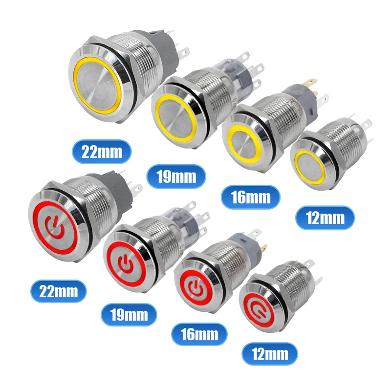

They have cable entries on both sides and the bottom. I would look at mounting a suitable momentary push button in one of those. In the past I have used these which are worth not waiting for the slow boat from China, plus better quality and weatherproof.
