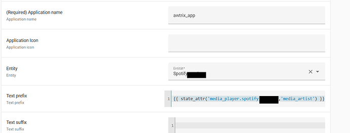

could someone give me a hint why the “now playing” blueprint does not reconise my Awtrix display ?
Here the screen from the Blueprint:
The services are created correctly by the custom component :
Thank you

Now I need just to get the Payload right into the text input fields:
When I use this formula in the text prefix field :
{{ state_attr(‘media_player.spotify_XXXXX’,‘media_artist’) }}
My Display shows only
PLAYING
isn’t it this the correct synthax ?
no.
text prefix - empty
text suffix - empty
additional options
playing_state: "{{ states(entity_id) }}"
title_template: "{{ state_attr(entity_id, 'media_title') }}"
album_template: "{{ state_attr(entity_id, 'media_album_name') }}"
artist_template: "{{ state_attr(entity_id, 'media_artist') }}"

value_template: >-
{{ playing_state~': '~(artist_template ~ ' - ' if artist_template else '') ~
(title_template if title_template else '-') ~ (' ÷ ' ~ album_template ~ ' ÷ '
if album_template else '') }}
also you may add condition
additional_conditions:
- condition: template
value_template: "{{ playing_state == 'playing' }}"
it will be useful for hide player when player is not playing…
THIS IS AMAZING!
Thank you soooo much! Everything works perfectly !
