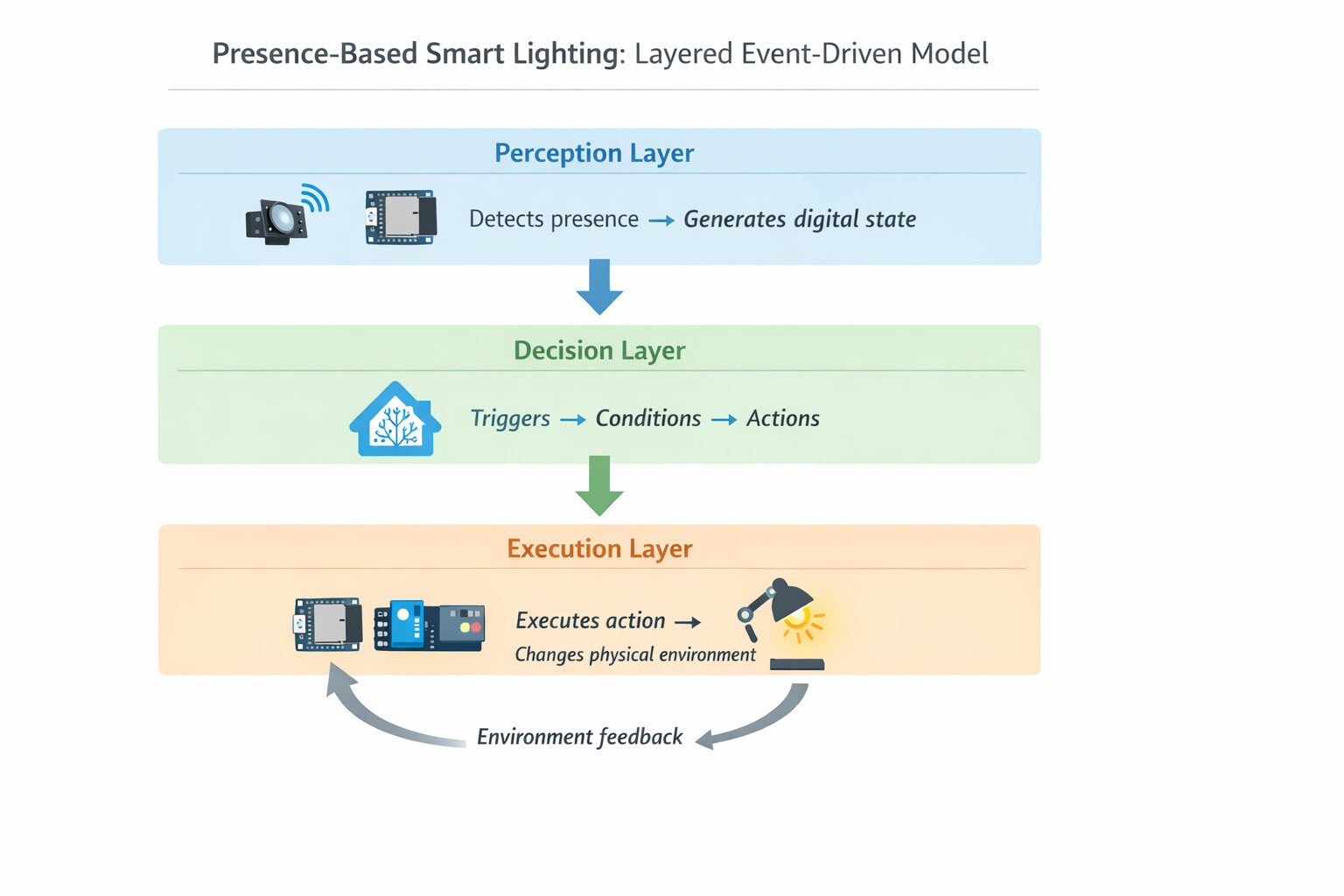

A presence-based smart lighting system is essentially a distributed intelligent system, composed of multiple layers working together: Reality Layer, Perception Layer, Communication Layer, Decision Layer, and Execution Layer.
The system works by converting physical changes into digital states, processing them through automation logic, and finally executing actions in the physical environment.

  • Decision Layer: Listens for state changes, triggers automation rules, and generates control commands. These commands are sent to the execution layer.
  • Execution Layer: Composed of the ESP32-C6 and relay, it receives commands to control the lighting.
The entire process forms a complete behavioral loop: physical changes lead to data changes, data changes trigger logical evaluation, and logical decisions drive physical actions.
With this layered architecture, each layer is responsible only for its specific role—the perception layer collects data, the communication layer transmits data, the decision layer performs logical evaluation, and the execution layer carries out actions. This clear separation of responsibilities results in a system that is both well-structured and highly scalable, reflecting how real smart home systems operate.

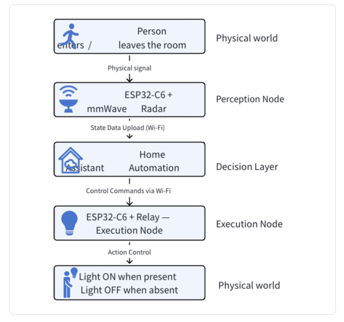

Let’s analyze the system workflow starting from real-world behavior.
As illustrated in the diagram, the system operates as a distributed, event-driven architecture. The perception layer converts physical changes into digital states, the communication layer transmits data via Wi-Fi and MQTT, the decision layer evaluates automation logic within Home Assistant, and the execution layer controls the relay to turn the light on or off according to the generated commands.
The entire process forms a complete closed loop: physical changes → data changes → logical evaluation → action execution → physical environment changes. This is the fundamental operating model of a smart home system

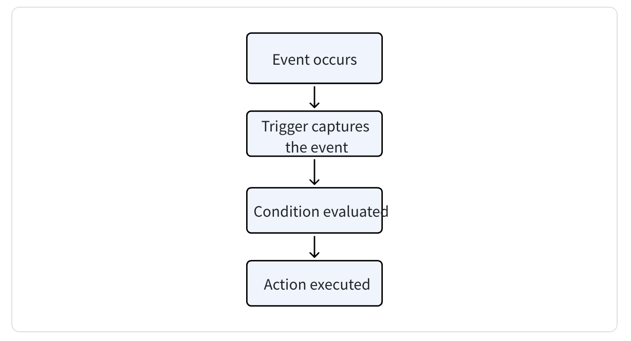

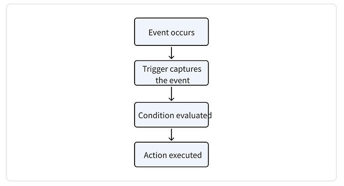

Each automation rule typically consists of three key elements: Trigger, Condition, and Action. The trigger starts the automation, the condition determines whether it should proceed, and the action performs the final task. In simple terms, the logic can be summarized as: when an event occurs (Trigger), and the specified conditions are met (Condition), the system executes the corresponding operation (Action).
Trigger: A trigger defines the event that starts the automation. It is the starting point of any automation; without a trigger, the rule will not run. For example, a presence sensor state changing from “no one” to “someone,” or from “someone” to “no one.”
Condition: A condition further filters the execution logic after the trigger has fired. For example, you might set the automation to run only at night or only if the light is currently off.
Action: The action is the final operation performed by the automation rule. When the trigger is activated and all conditions are met, the system executes the corresponding action, such as turning a relay on or off.
