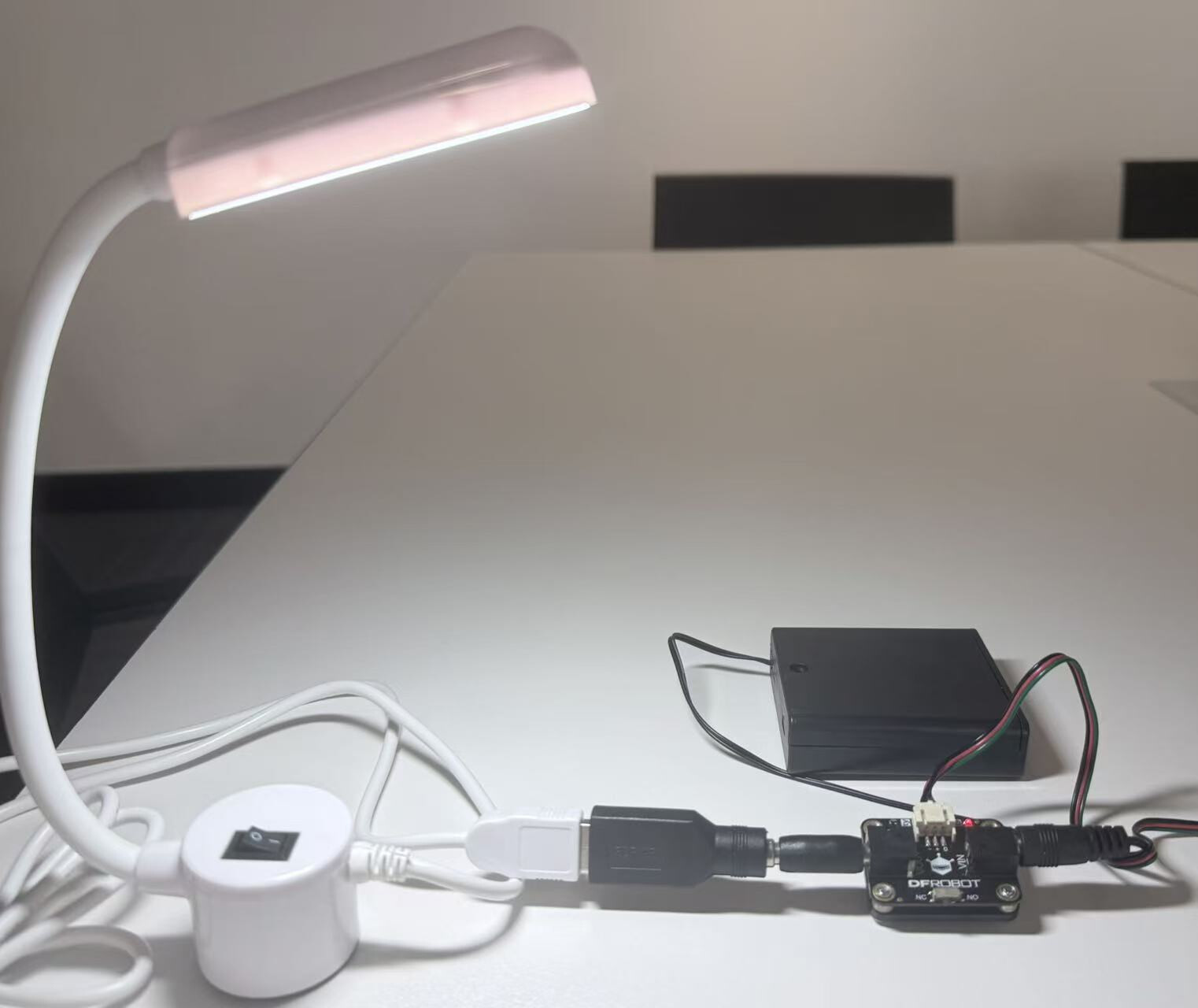

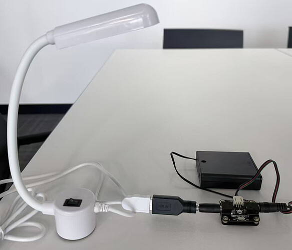

I’m an avid reader and wanted a smart light automation setup for my desk that turns on automatically whenever I’m present.Initially, I tried using a standard PIR motion sensor. However, I quickly ran into a common problem: the lights would often turn off while I was sitting still. This is a frequent frustration in many setups using Home Assistant.
To solve this, I switched to a C4002 mmWave radar sensor, which can detect subtle human presence and micro-movements, keeping the lights on even when I’m completely still.Using ESPHome, I integrated the sensor with Home Assistant to create a seamless and responsive auto-lighting experience.

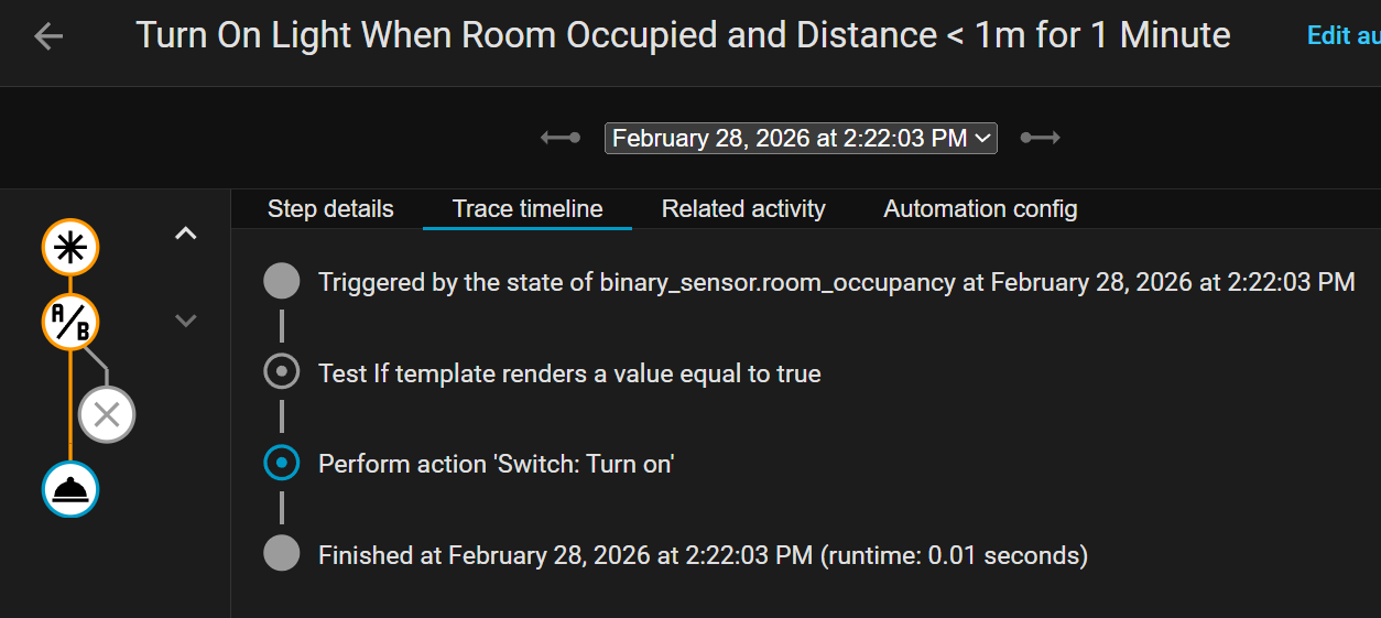

The desk light turns on automatically when the following conditions are met:
  • The sensor detects human presence
  • The detected distance is less than 2 meters
  • The presence lasts for more than 1 minute
Action: Turn on the desk light.

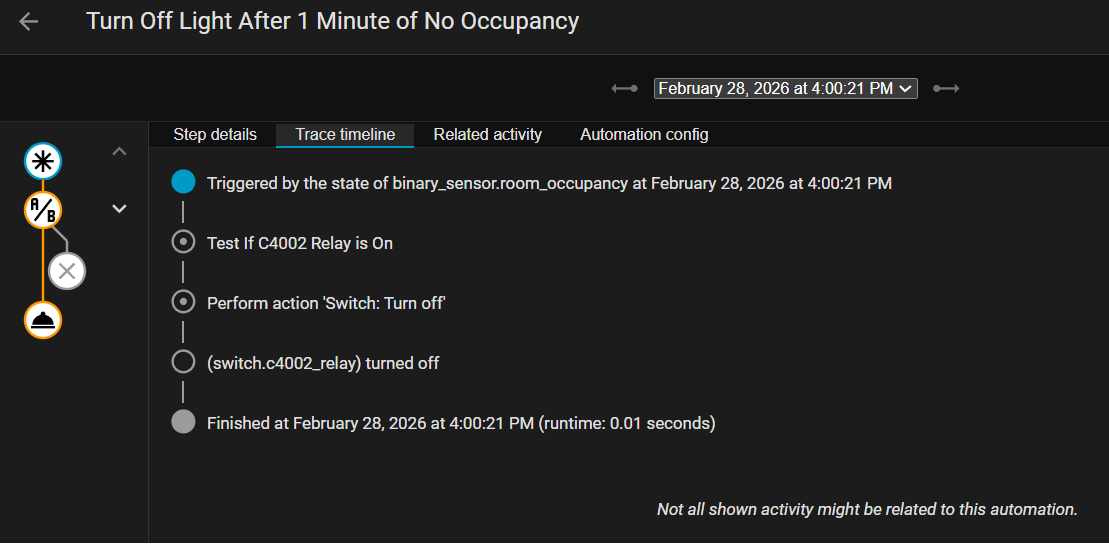

The desk light turns off automatically when:
  • No presence is detected for 1 minute
  • The desk light is currently ON
Action: Turn off the desk light.
