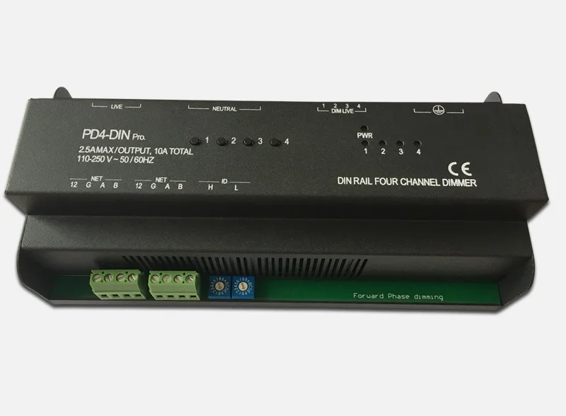

I found these on aliexpress and wonder about their use for a diy Lighting Panel.
Leading Edge Dimmer
US $199.90 | 4 Channels Dimmable Module RS485 LED Lighting Dimmer Dimming Switch 86 APP Scene Control Suppports Android iOS Control4 Crestron
0-10V Dimmer
US $154.90 | 8 Channels Dimmable Module 0-10V for LED Lighting Dimmer Dimming Switch Control RS485 Supports CRESTRON Control4 Andriod iOS
Relay
US $89.99 | 8 Channels Intelligent Relay Switch RS485 for Lighting Curtains 86 APP Scene Control Supports Android iOS Control4 Crestron
