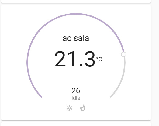

I tried the new Lovelace Thermostat card with broadlink climate but it doesn’t work.
when I move the dial, or change from heat to cold this is triggered:
But then I get this error:
Error doing job: Task exception was never retrieved
6:13 PM custom_components/climate/broadlink.py (ERROR)

Is there a way of making it work with broadlink climate component? Any info I can provide in order to help?
thanks
I’ve just tested mine in lovelace and all working as expected. Just check that you are running the latest version of the custom component.
