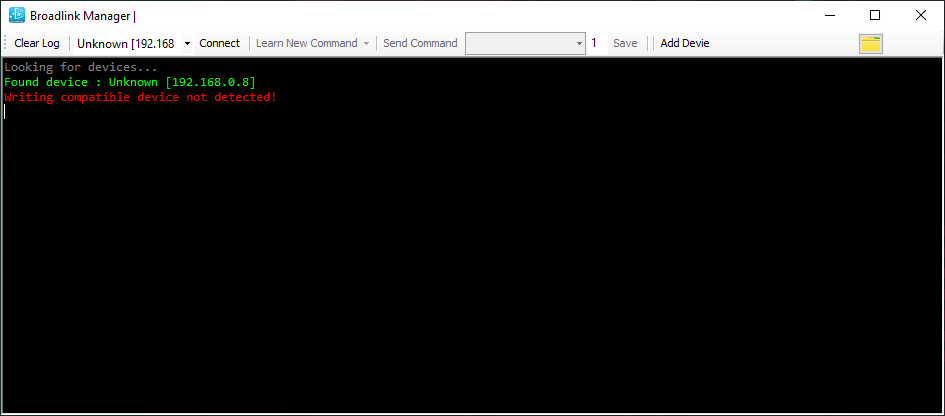

I am trying to connect a BroadLink RM4 Pro and RM4 Mini but I am not able to through the app.
I am getting a Writing compatible device not detected message although it is detecting it in the network.
Anything else I should know of that maybe my router is blocking the connection or anything? I made sure the device is set to Lock Device disabled through the mobile app.
In desperate need of guidance.
