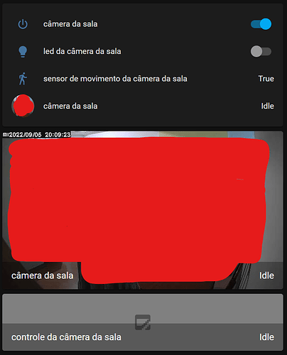

I have a 05 mode od camera, adden by Xiaomi auto integration, added cuztomization to mail entity (camera Control) keep streaming true and video attribute 3, disabled pin on Xiaomi app and enabled home monitoring but camera os still on idle mode.
There os no loop or delay😱
