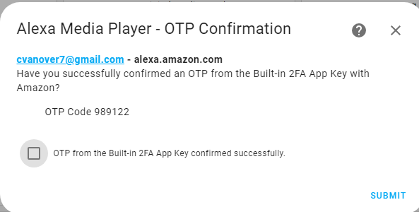

I’m not getting this screen like you though
Perhaps it depends on the domain? Not sure. Anyway the process I described above is the usual one which always worked fine, I have no idea what’s wrong this time…
This is your problem: (left the rest as default). You need to enter the app secret so that AMP can self-generate an OTP code. The OTP code is not just required during onboarding but is necessary for AMP to be able to re-login to Amazon when it needs to reauthenticate.
