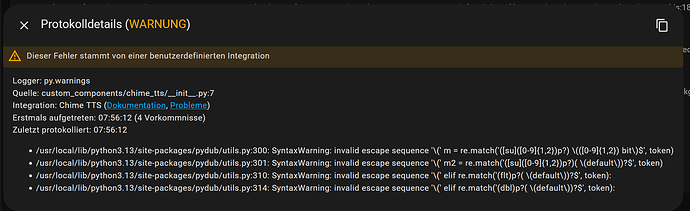

Hi!
I`ve got a Log entry after boot…
Should i do something ?
