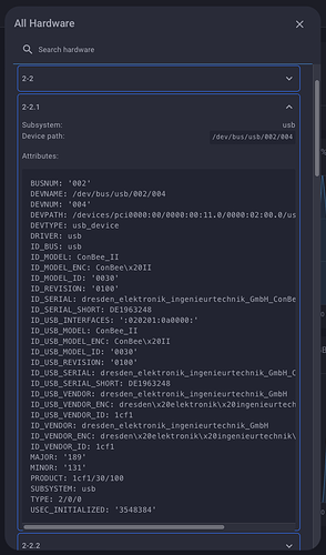

And one more hint, as this might be tricky to identify devices in VA VM, as these might have strange names on OS level…
So for Deconz it looks following (on my system). In Hardware configuration of HA:
In Deconz add-on configuration panel:
