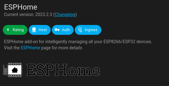

@finity What about your ESPHome version?

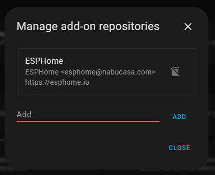

A while ago ESPHome changed to a core-addon; it won’t update automatically.
Easiest is to just delete your current add-on, and re-install it (don’t worry about loosing data; as it is stored outside the container you won’t loose any data)
