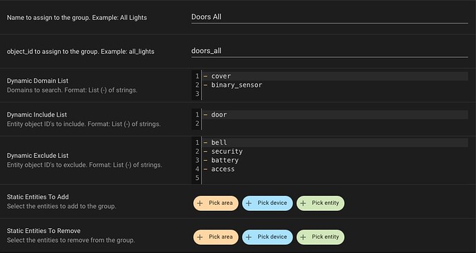

Recommended Steps for Creating a Dynamic Group
First familarize yourself with domain and object_id state objects.
Start with a broad brush.
- Add a domain in
Dynamic Domain List
. Example: - light - Add a string in
Dynamic Include List
. Example: - bedroom - Save the automation and run it.
- View the group created, (Configuration → Entities → in the search bar enter ‘group’, click the group) and its members.
- Make note of the members that need to be removed and strings they have in common.
- If necessary, edit the object IDs of the members and add identifiers to make them easier to exclude.
Then narrow the scope.
- Go back to the automation and in
Dynamic Exclude List
add a list of common strings to exclude. - Save and run the automation then go back to the group to view updated list members.
Rince and repeat.
- Continue this process until only the members you want are in the group.

Dynamic Domain List
, Dynamic Include List
, and Dynamic Exclude List
Strings entered in these fields need to be entered as a yaml list. For example:
- light
or for multiple strings
- light
- lock
Static Entities To Add
, and Static Entities To Remove
Multiple entities can be added to these fields. If devices are added, expand the device and remove unnecessary entities.
