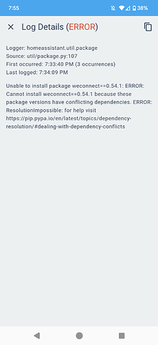

Setup failed for custom integration volkswagen_we_connect_id: Requirements for volkswagen_we_connect_id not found: ['weconnect>=0.54.0'].
Similar error after HA Update
Same issue after update of HA
Have same error with 0.1.6. HA logs states:
Unable to install package weconnect>=0.54.0: ERROR: Cannot install weconnect==0.54.1, weconnect==0.54.2 and weconnect==0.55.0 because these package versions have conflicting dependencies

For the Cupra Born version it was enough to change the /config/custom_components/volkswagen_we_connect_id/manifest.json file
The line with the requirements
"requirements": ["weconnect-cupra-daern==0.49.20", "ascii_magic==1.6"],
I think you need to change this line in the ID.x version to:
"requirements": ["weconnect>=0.54.0", "ascii_magic>=2.0.0"],
Just a guess.

I just yesterday rolled HA back from 2023.6.2 to 2023.5.4 and all is working perfectly again. And this morning an update for integration has been published, which states fixes for e.g.:
- fix: depenecy conflicts by @flixlix in fix: depenecy conflicts by flixlix · Pull Request #185 · mitch-dc/volkswagen_we_connect_id · GitHub
