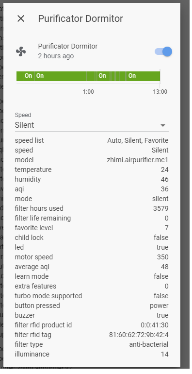

Please add for this card the possibility to show custom entity pictures from customization.
Also it will be much appreciated if you can make a custom tile for Xiaomi Air purifier. I saw a lot of users that has one.

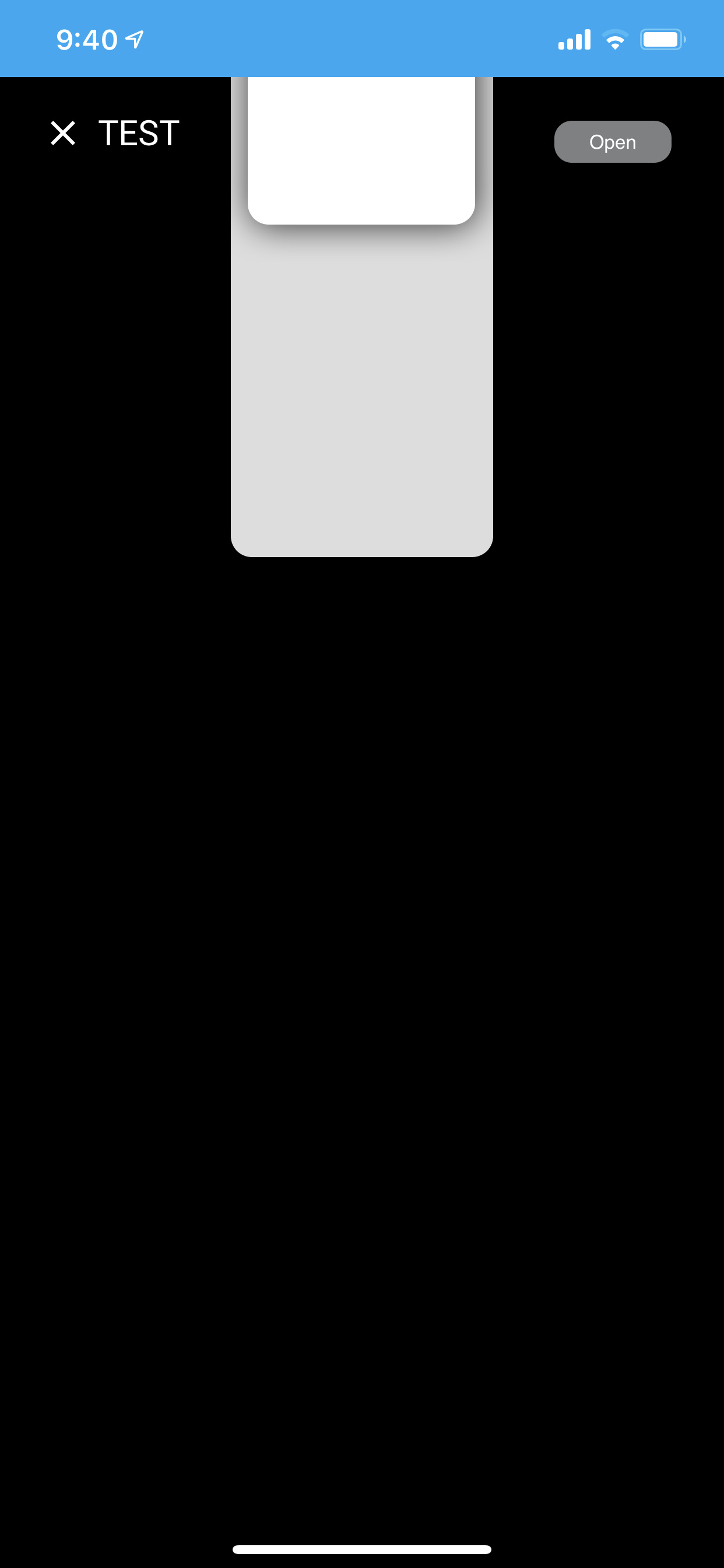

I’ve got it installed and working, but I have a few issues with configuring it.
First issue is that the popup is a switch, and not a dimmer. The light I am using is a dimmer. I’m not sure how to get the popup to be a dimmer instead of a switch.
Second issue is that half of the switch is off my screen, and i’m not sure how to fix it.
I’m using this in a picture-elements card with the Browser-mod popup option. Here is the YAML i have currently:
#OFFICE
- type: state-icon
entity: light.office
tap_action:
action: toggle
hold_action:
action: call-service
service: browser_mod.popup
service_data:
title: TEST
popup_cards:
light.office:
card:
type: custom:light-popup-card
icon: mdi:lightbulb
actionsInARow: 2
brightnessWidth: 150px
brightnessHeight: 400px
switchWidth: 150px
switchHeight: 400px
settings:
openButton: Open
closeButton: Close
settingsCard:
type: entities
cardOptions:
entities:
- light.hallway
- light.bedroom
cardStyle: |
backgroundcolor:#FFF;
deviceID:
- this
style:
top: 41.25%
left: 68%
transform: 'scale(1.5, 1.5)'
Any help would be greatly appreciated

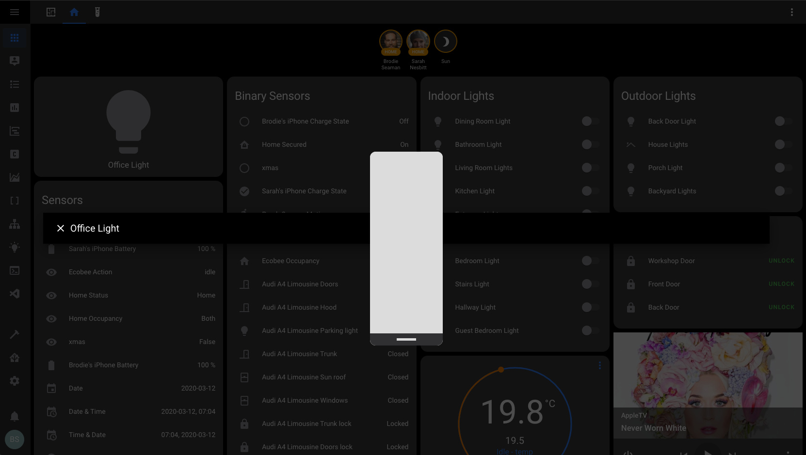

I managed to get the dimmer to be recognized as a dimmer by adding
supportedFeaturesTreshold: -1
I am still having the same issue with alignment of the popup. It seems that anything i put in the style: section has no effect on the popup.
I added the same configuration i used above to a button card and I still have the same issue. This is what i see on my desktop:
cards:
- type: button
hold_action:
service_data:
title: Office Light
popup_cards:
light.office:
title: ""
style:
position: fixed
z-index: 999
top: 100px
left: 0
height: 100%
width: 100%
display: block
align-items: center
justify-content: center
background: rgba(0, 0, 0, 0.5)
flex-direction: column
margin: 0
card:
