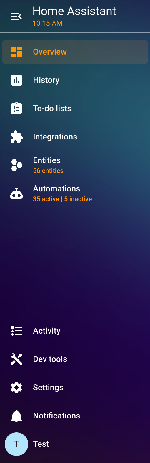

Check all the options in the documentation, all the possibilities are documented there. But just some things (among others) that you can achieve with this custom plugin and it is not possible natively:
  1. The changes are stored in a config file so if you logout and login again, they don’t get lost. The same applies to different devices, every time that you log-in in a device the configuration that match with your username is taken from the stored config.
  2. You can change the icon or rename the sidebar items
  3. You can move items to the bottom group of the sidebar
  4. You can dynamically add notifications to the items in the sidebar (for example, display the number of HACS updates as a notification in the HACS sidebar item)
  5. You can use JavaScript/Jinja templates in some of the elements
