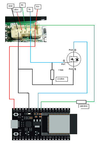

i developed a MQTT Autodiscovery message for hvac and explained to the developer Adrian Kennard how to handle the autodiscovery fom HA. He integeated the Autodiscovery for HA in his Project and opend some MQTT settings on the webinterface. now you are able to connect the controller to HA and with Autodiscovery everything will setup buy itself.
i use this board:
i used this tool to flash the project.
i flashed the Daikin-S1.bin on the board
the S21 connector on my PCB is the:
housing: jst pap-05v-s
pins: SPHD-002T-P0.5
(for building your own S21 cable)
I diddn´t used the 15V pin, i connected my ESP32 board to the used 5V supply pin.
now i strat the rollout on the rest
big thanks to Adrian Kennard nice work

I assume you had to solder the other ends of the wires to the ESP32 dev board? If so, which pins go where?
i draw a little circuit diagram how i made it (quick and dirty)
