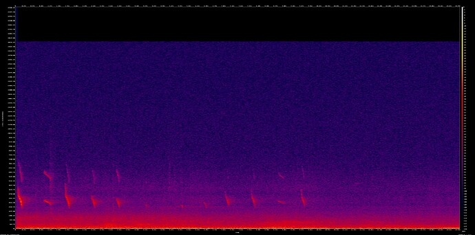

How did you extract that spectrogram? Does anyone know how to extract it as a plain image? My main goal is to use it in a picture-elements card, like this, but it’s still just the thumb of the sound file and renders too slow to sync with the sensor update, so it show as unavailable when a new bird is recognized.
Skjermbilde 2024-08-22 kl. 16.15.06
The card:
  - type: picture-elements
    image_entity: image.garden_bird_photo
    elements:
      - type: custom:config-template-card
        entities:
          - sensor.garden_bird_recording
        element:
          type: image
          image: ${ states['sensor.garden_bird_recording'].state }
        style:
          top: 13%
          left: 16%
          width: 30%
          opacity: 0.6
          border: 2px solid white
The sensor:
template:
  - sensor:
      - name: "garden bird recording"
        state: "{{ 'http://192.168.86.64:8123/api/hassio_ingress/**token**/spectrogram?clip=' ~ state_attr('sensor.garden_birds', 'ClipName') }}"
        attributes:
          url: "{{ '/api/hassio_ingress/**token**/spectrogram?clip=' ~ state_attr('sensor.garden_birds', 'ClipName') }}"
My spectrogram isn’t scraped from my birdnet install at all.
As I sort of mentioned previously (though maybe not clearly), I split up my outdoor station (with the microphone) from the actual processing. I’m using birdnet-go rather than birdnet-pi, and the go version supports receiving microphone input via RTSP.
My outdoor node with the mic is running two services:
  1. mediamtx, which serves the rtsp stream
  2. a service that runs ffmpeg which reads from the mic, generates the spectrogram, and passes that audio+video feed to the rtsp socket run by the previous service
Here is my ffmpeg command (some of this may be hardware-specific):
ffmpeg -hide_banner -f alsa -ac 1 -i "hw:CARD=Device,DEV=0" -filter_complex "[0:a]showspectrum=s=hd480:mode=combined:slide=scroll:saturation=0.5:color=rainbow:scale=log,fps=15,format=yuv420p[v]" -map "[v]" -map 0:a -c:v libx264 -c:a aac -b:a 128k -f rtsp -rtsp_transport tcp rtsp://localhost:8554/birds
My indoor node just ingests that RTSP stream and handles the detection.
I’m not sure that any of that helps with your goal though, since it is pretty heavily geared for running it live… If you are saving the sound files somewhere you may be able to use ffmpeg to generate non-thumbnail versions of those spectrograms? Here is a spectrogram of a 15s recording of an osprey that I picked up yesterday, generated with
ffmpeg -i pandion_haliaetus_100p_20240902T180913Z.wav -lavfi showspectrumpic pandion_haliaetus_100p_20240902T180913Z.png
This took my machine ~1.5s to generate. You could obviously have ffmpeg drop the labels and stuff and generate a different resolution or whatever else you wanted as well.
