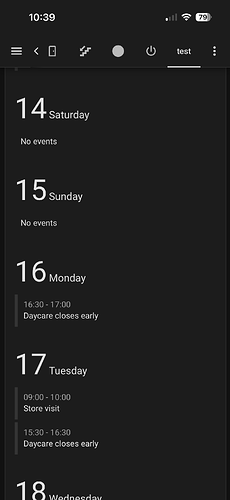

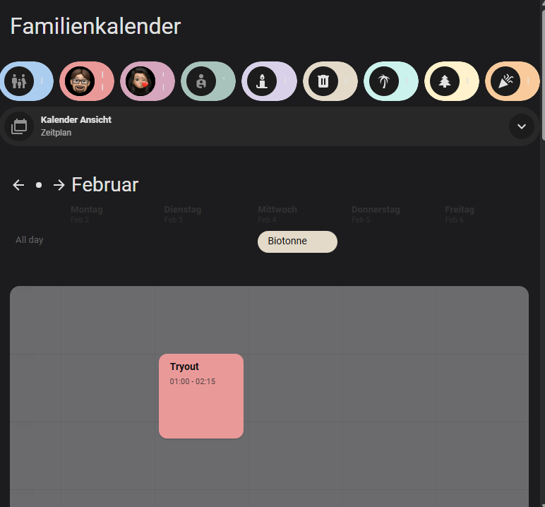

Week view:
schedule view:
I will work on this tonight after work. We can fix these issue no problem.
