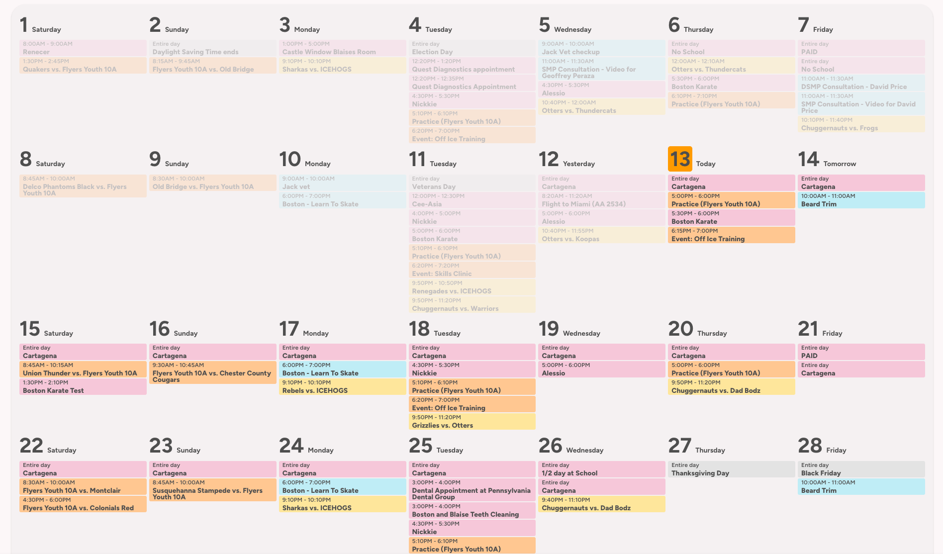

I want the calendar to start on Sunday, like a typical wall calendar does in the US. With what you are suggesting the month starts on the starting day. So for the month of november, November 1st is on a saturday and the calendar for this month goes Saturday - Sunday each week, instead of Sunday - Saturday like a normal wall calendar would. Look at the attached image. I want the calendarto be shifted so it starts on a sunday, not saturday, Saturday Nov 1st should be put all the way to the right on the first row by itself and Nov 2nd should be first on the next row so it starts with a Sunday.
@lanceblaise I see what you mean now.
It’s somewhat possible but you need to adjust the settings every time :frowning: Would probably be easier to ask for feature update on github.

Here is part of my calendar YAML that formats the month (next 31 days) but the starting day is always Sunday (first column). It also won’t show the past days and weeks and ā€œresetsā€ itself every Sunday.
And it was a request to change the month name so we can have an emoji…it was a feature of the hand written calendar that needed to continue :slight_smile:
days: 31
  startingDay: today
  startingDayOffset: 0
  timeFormat: h:mm a
  hour12: true
  hideWeekend: false
  noCardBackground: false
  compact: false
  weather:
    showCondition: true
    showTemperature: true
    showLowTemperature: false
    useTwiceDaily: false
    entity: weather.forecast_home
  locale: en-US
  showLocation: false
  hidePastEvents: true
  hideDaysWithoutEvents: false
  hideTodayWithoutEvents: false
  combineSimilarEvents: true
  showLegend: false
  legendToggle: false
  showNavigation: true
  texts:
    monday: Mon
    tuesday: Tue
    wednesday: Wed
    thursday: Thu
    friday: Fri
    saturday: Sat
    sunday: Sun
    yesterday: ""
    today: ""
    tomorrow: ""
    overmorrow: ""
    fullDay: ""
    noEvents: ""
  card_mod:
    style: |
      ha-card {
        font-family: 'Ovo';
        .container .navigation .data-year {
            position: static;
            right: 60px;
        .event.past {
          opacity: .2;
          background-color: gray !important;
        .container .data-week {
         display: none !important;
        .time {
          color: #333333 !important;
          font-size: 0.8em !important;
        .event {
          line-height: 16px !important;
          background-color: var(--border-color) !important;
          border-radius: 10px !important;
          max-height: 100px !important;
          overflow: hidden !important;
          font-size: 1.1em !important;
        .none {
          background-color: transparent !important;
        .today .number {
          border-radius: 5px;
          background-color: #A3C4F3 !important;
          padding-left: 4px;
          padding-right: 4px;
        .today {
          border: solid 2px #000000 !important;
        .day .date .text {
          font-size: 1em !important;
          font-weight: bold !important;
        .day .date .number {
          font-size: 3em !important;
        .day {
          --background-color: red;
          border: solid 1px whitesmoke;
          display: flex !important;
          flex-direction: column !important;
          justify-content: flex-start !important;
          align-items: stretch !important;
          min-height: 15px !important;
          width: 100% !important;
          padding: 0 !important;
        .day .event {
          white-space: normal !important;
          word-break: break-word !important;
        .container {
          display: grid !important;
          grid-template-columns: repeat(7, 1fr) !important;
          grid-template-rows: auto !important;
          gap: 8px !important;
          padding: 0px !important;
        .container .header,
        .container .legend {
          grid-column: 1 / -1 !important;   /* span full width */
          grid-row: 1 !important;
          justify-content: center !important;
        .navigation {
          flex-direction: row !important;
          align-items: center !important;
          margin-bottom: 0px !important;
          text-align: center !important;
        .navigation .month {
          color: transparent !important;       /* hide original text */
          position: relative !important;
          white-space: nowrap !important;
        .navigation .month::after {
          content: "November 🦃" !important;  /* new text */
          color: #000000 !important;           /* your desired color */
          position: absolute !important;
          left: 0;
          top: 0;
          padding-right: 4px;
        /* Reorder days so Sunday is first column */
        .day[data-weekday="1"] { grid-column: 2 !important; } /* Monday */
        .day[data-weekday="2"] { grid-column: 3 !important; } /* Tuesday */
        .day[data-weekday="3"] { grid-column: 4 !important; } /* Wednesday */
        .day[data-weekday="4"] { grid-column: 5 !important; } /* Thursday */
        .day[data-weekday="5"] { grid-column: 6 !important; } /* Friday */
        .day[data-weekday="6"] { grid-column: 7 !important; } /* Saturday */
        .day[data-weekday="7"] { grid-column: 1 !important; } /* Sunday */
        .week.past-week {
