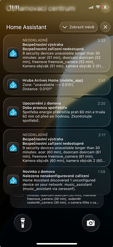

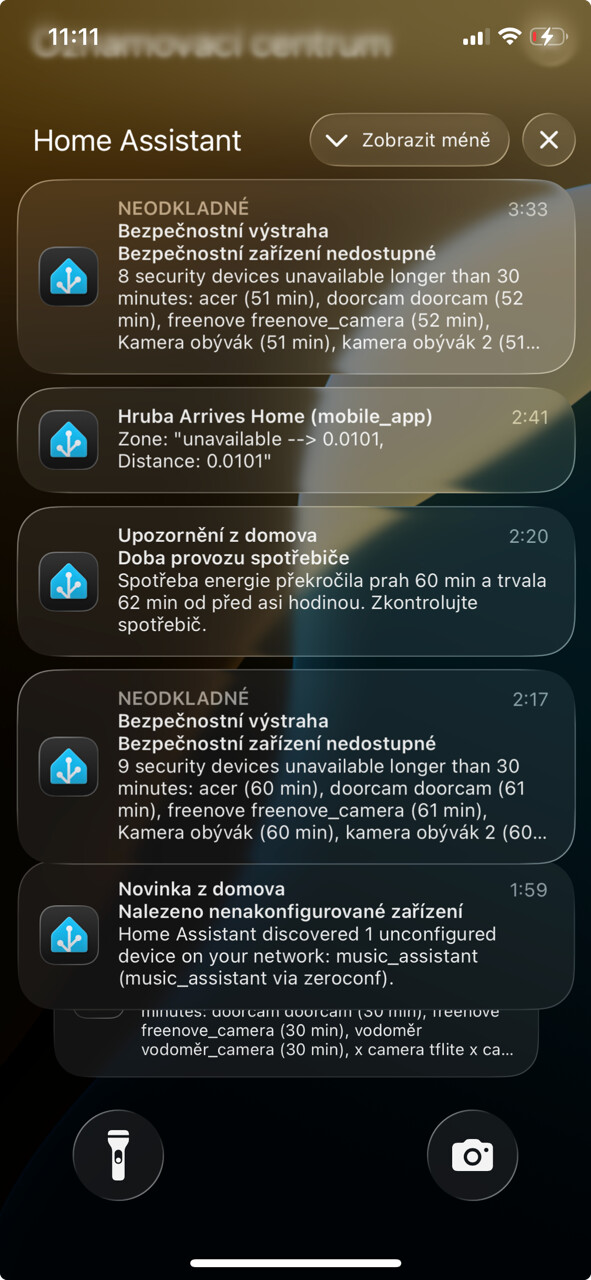

I track unavailable entities and devices: it’s on a dashboard, but the important part are the notifications I get.
I also have ping sensors for a number of devices.
I also have some sensors that check for activity, because some entities might be available, but the device isn’t sending valid values anymore.
