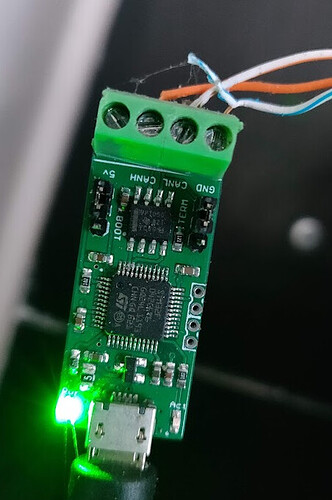

I try the canable module. I connect can L to RX from DObiss and Can H to TX. I install can-utils and then i start the connexion with
sudo ip link set up can0 type can bitrate 125000
and then
candump can0
but I don’t receive any answer.
do you have an idea of the possible problem?
is ground always necessary.
I read also something about a resistor!
thanks
I also try to send
cansend can0 00800102#00450101
module E, relay 1
but without succes as well.
  1. i dont have TX RX , i just have H / L , and also GND connected, verry important, i broke my can controller before on my max, because GND was not connected
  2. i have the jumper enabled to termination on my canable
  3. Make sure to use a good USB cable, some usb cables are charge only, you need one wirth charge + data
  4. I use SLCAN firmware on it, i had better experience with it, on my custom component, when HA starts, those commands are fired, try them first in SSH, and then do a candump can0, normally you should see stuff coming in when you turn on a light from a button

Got my Canable, where do you connect your ground?
I have H / L / Gnd on my max200, so connected to gnd :slight_smile:
Got it connected. Got some trouble following your guide.
I get the message slcan command not found. Any chanse you had the same problem?
Have you installed can tools?
Its slcand …not slcan
Thats indeed a typo stuppid of me. But without the typo i get the same result.
I installed can-utils is there somthing else i need to install?
no, should be enough? see here example
show me your output too ?
I’m not using home assistant os.
Running a default ubuntu server.
Seems it’s not detecting the USB stick? Can you check your attached USB devices?
Have you put slcan firmware on it?
I assumed it was already going to be on there.
I have just done this via the site https://canable.io/updater/
But unfortunately.
