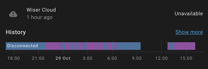

It’s been connected to the cloud, but a LOT of disconnects
