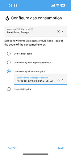

That’s exactly what I did using the gas consumption dialogue.
I entered two sensors the energy consumption of the appliance (kW) and the cost of consumption ($/ kW) and the energy dashboard calculates daily/ weekly/ monthly/ yearly energy consumption and cost values.
How do you add KWh sensors to the Gass consumption? Care to share?
Like this:
And result:
Sure,
I got the daily energy sensor for my Fridge (it has a smart plug that reports energy to Home Assistant.
sensor.fridge_energy
and my consumption cost from my energy provider as it varies during the day (or you can use a fixed cost).
sensor.house_consumption_cost
and then in the energy dashboard setting I added the appliance as a new ‘gas source’
But to the `gas sources I am only able to add Cubic Meter sensor and not Kwh?
What does the actual sensor look like?
If you have a look at the above ‘configure gas consumption’ dialogues above you will see it accepts Wh, kWh or MWh, but yours doesn’t.
Do you already have a gas source configured for m3, if so maybe delete from gas sources and see if you can add other units sensors.
Excellent! that was it. I removed it and now are able to add these sensors. Cool! Thank you!
