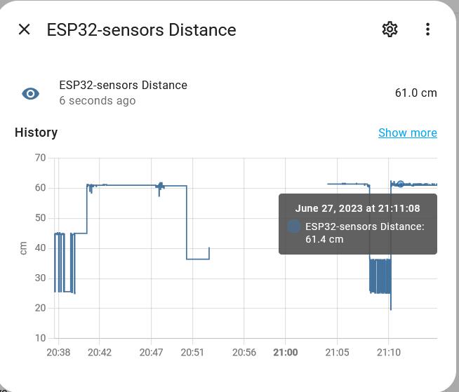

I’m trying to get my ultrasonic sensor to work with ESPHome. The sensor is a JSN-SR04T-AJ-SR04M which is similar to the HC-SR04 but not exactly the same. So using the default ESPHome template ‘ultrasonic’ doesn’t work (wrong distance values are show, only 2 out of 10measurements are somewhat correct).
The SR04 has different modes, I soldered a 47kΩ resistor into the R27 Pin to enable the “contious mode”. In this mode the distance calculation is done on device all the time. To get the distance on can use the UART to retrieve the data.
Now I’m struggling with implementing this in ESPHome. I read that it is possible to add custom UART components, but I’m not sure if this is necessary in my case, or if I’m able to just receive the data using the regular uart integration.

I faced the same challenge. Here my solution based on a custom sensor. Hope it will help you out…

The update interval is fixed to 5 seconds but you can change it accordingly.
I am trying to use your code but the sensor is not updated.
Distance
Unknown
Any tips?
I managed to make it work:
