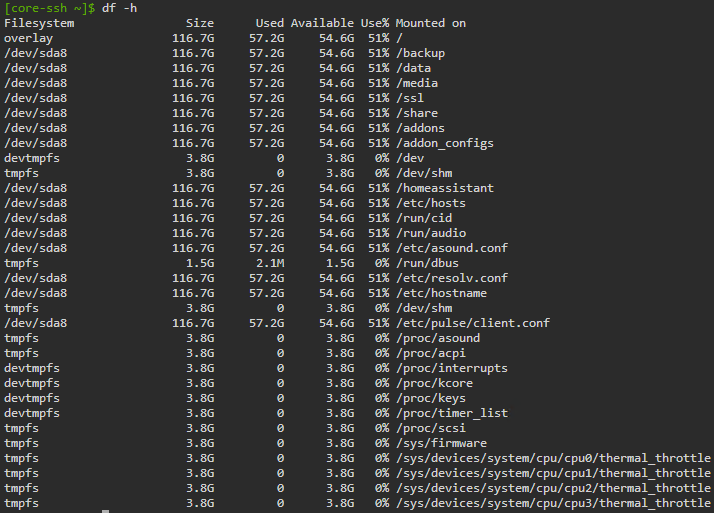

I’ve tried the Samba add-on as suggested here SOLVED: Beginner’s guide to using a USB Drive on HAOS for Frigate Media : r/homeassistant
However I’m not convinced its mapped it as when I run a df in HA ssh add-on the space used for /media is the same for all mounts. The USB drive is 1TB.

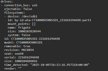

If I run “ha hardware info” it lists the USB drive as /dev/sdb1
