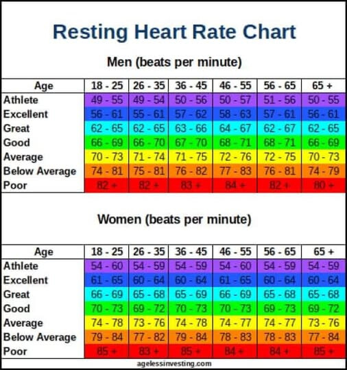

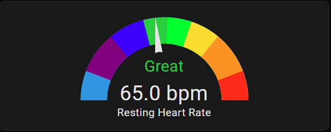

Resting Heart Rate
  • segments: Non Gradient color segments
  • value_texts: secondary_value: Template to produce a word rating
  • value_texts: secondary_color: Template to change secondary text color inline with segments
Card Code
type: custom:gauge-card-pro
entity: sensor.cph2271_resting_heart_rate
segments:
  - from: 50
    color: purple
  - from: 57
    color: blue
  - from: 63
    color: limegreen
  - from: 67
    color: lime
  - from: 71
    color: gold
  - from: 76
    color: darkorange
  - from: 83
    color: red
needle: true
gradient: false
titles:
  primary: Resting Heart Rate
min: 45
max: 88
value_texts:
  secondary: >-
    {% set bpm = states('sensor.cph2271_resting_heart_rate') | float(default=0)
    %} {% if bpm >= 50 and bpm <= 56 %}
      Athlete
    {% elif bpm >= 57 and bpm <= 62 %}
      Excellent
    {% elif bpm >= 63 and bpm <= 66 %}
      Great
    {% elif bpm >= 67 and bpm <= 70 %}
      Good
    {% elif bpm >= 71 and bpm <= 75 %}
      Average
    {% elif bpm >= 76 and bpm <= 82 %}
      Below Average
    {% elif bpm >= 83 %}
      Poor
    {% else %}
      Unknown
    {% endif %}
  secondary_color: >-
      purple
      blue
      limegreen
      lime
      gold
      darkorange
      red
    {% else %}
      black
    {% endif %}
I saw it pop-up on my youtube, I was shocked! Never imagined my card would get this kind of traction :blush:
Great example, thanks for sharing! At some point I changed the 2nd value_text from being tied to the inner-gauge to just independent elements, exactly for use-cases like this

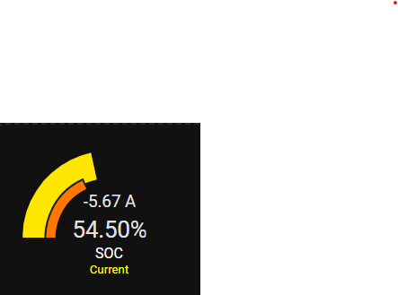

Trying to do the same on a card for a Lifepoe battery but the primary and secondary colors are not changing can’t see what I’m getting wrong any help would be appreciated
cards:
  - type: custom:gauge-card-pro
    segments:
      - from: 20
        color: red
      - from: 40
        color: "#FFA500"
      - from: 60
        color: rgb(255, 255, 0)
      - from: 75
        color: var(--green-color)
    needle: false
    gradient: true
    titles:
      primary: SOC
      secondary: Current
      primary_color: white
      secondary_color: yellow
      primary_font_size: 12pt
      secondary_font_size: 10pt
    entity: sensor.bp00_battery
    entity2: sensor.bp00_current
    inner:
      segments:
        - from: -20
          color: red
        - from: 0
          color: "#FFA500"
        - from: 10
        - from: 20
      max: 20
      mode: severity
      gradient: true
      gradient_resolution: medium
      min: -20
    min: 20
    max: 100
    hide_background: true
    value_texts:
      primary_font_size_reduction: 10
      secondary_color: |-
        {% set cur = states('sensor.bp00_current) | float(default=0)
            %} {% if cur <= 0 and cur <= 2 %}
              red
            {% elif cur >= 3 and cur <= 5 %}
              yellow
            {% elif cur >= 6 and cur <= 10 %}
              gold
            {% elif cur >= 11 and cur <= 15 %}
              limegreen
            {% elif cur >= 16 %}
              green
            {% else %}
              black
            {% endif %}
      primary_color: |-
        {% set soc = states('sensor.bp00_battery) | float(default=0)
            %} {% if soc >= 0 and soc <= .30 %}
              red
            {% elif soc >= .31 and soc <= .50 %}
              yellow
            {% elif soc >= .51 and soc <= .75 %}
              gold
            {% elif soc >= .76 and soc <= .80 %}
              limegreen
            {% elif soc >= .81 %}
              green
            {% else %}
              black
            {% endif %}
    icon:
      type: template
      value: |-
        {% if is_state('binary_sensor.bp00_charging', 'on') %}
                      {{ { "icon": 'mdi:battery-charging', "color": "#00ff00" } }}
                    {% endif %}
Figured out the issue here’s the corrected code was missing a ’ after naming the sensor
secondary_color: >-
{% set cur = states(‘sensor.bp00_current’) | float(default=0)
red
yellow
gold
limegreen
green
{% else %}
black
{% endif %}
primary_color: >-
{% set soc = states(‘sensor.bp00_battery’) | float(default=0)
%} {% if soc >= 0 and soc <= 10 %}
red
{% elif soc >= 11 and soc <= 50 %}
yellow
{% elif soc >= 51 and soc <= 75 %}
gold
{% elif soc >= 76 and soc <= 80 %}
limegreen
{% elif soc >= 81 %}
green
{% else %}
black
{% endif %}
