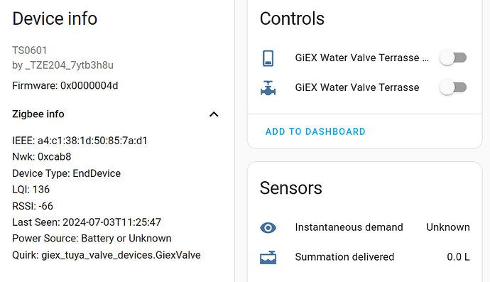

  1. Be sure your valve has at least the firmware version: 0x0000004d. I not you need to get a Tuya smart hub and install the Smart live app to upgrade the firmware. I did update from version v1.0,9 to v1.0,13. See screenshot below.
  2. If you haven’t done you need to get custom quirks running on HA instance.
    See → https://www.home-assistant.io/integrations/zha#how-to-add-support-for-new-and-unsupported-devices
    and → Zigbee Guide: How-to setup local custom device handler quirks in ZHA integration
    The quirk you will find here. zha-device-handlers/zhaquirks/tuya/ts0601_valve.py at 8317dc69c3b36e7ae5cabe40d7937c02ca259f77 · zigpy/zha-device-handlers · GitHub
I you have done this your valve should show similar as in this screenshot.

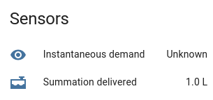

Now, after adding the device to the quirks, and when it is in range, it works… most of the time. One issue is that I don’t have feedback on the HA interface, I can “turn it on”, and it will show up as powered on in the interface, while nothing happens on the device. That and it not being reactive are my main gripes with it.
Otherwise, a few things to note:
  • The comments in the quirks file were extremely useful, as I can set it to just deliver N liters (or seconds). That alone makes it worth it, and I feel like it’s a failsafe in case the valve does not receive the turn off signal. It’s just a shame we don’t have that info in the interface or as settings; maybe I will add them as settings on the interface.
  • Volume measurement seems to be relatively accurate, but it is reset at the start of every cycle, which initially confused me.
  • Flow measurement (“Instantaneous demand” does not seem to be working for me. Would that be due to my firmware version?

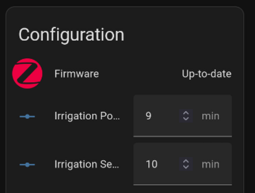

Just an update at the current version of ZHA in HA 2025.4 the firmware is shown in the field of the configuration section. But this image shows the Dual water timer.
I bought the Dual valve version in the meantime and it seems that a lot of the problems have been solved. The valve sits around 13 meters from a repeater with some obstacles in between. So connectivity is much better. But I can’t says how much the GX-02 has improved. The two that I have are now starting the second season.
