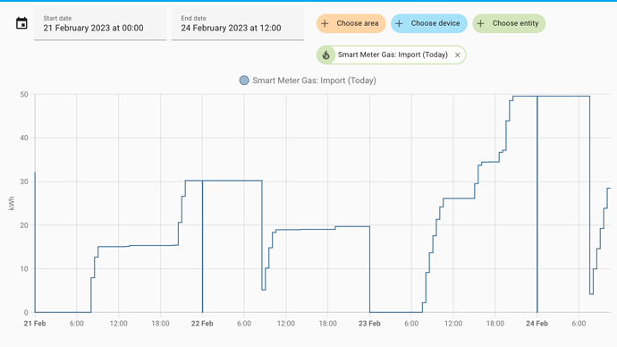

I am also having a similar issue but I think the cause is different. My issue is that gas usage being recorded per day isnt being zero’d properly at the start of each day. I am unsure if this is an issue with MQTT data being sent from the CAD Display or with the template sensor.
Below is the entity graph for gas use over the last few days, as you can see the value drops but then immediately returns to yesterdays highest reading, this then sorts itself out by about 6-7am but by that point the usage is already skewed as it is taking wrong information to start the calculations off with.
Has anyone else encountered this? Electricity usage seems fine. Ultimately the usage data is right its just that the daily reset doesn’t happen properly.
The mqtt sensor is exactly as provided above:
unique_id: "smart_meter_gas_import_today"
state_topic: "glow/XXXXXXXXXXX/SENSOR/gasmeter"
device_class: "energy"
unit_of_measurement: "kWh"
state_class: "measurement"
value_template: >
{% if value_json['gasmeter']['energy']['import']['day'] == 0
and now() > now().replace(hour=0).replace(minute=1).replace(second=0).replace(microsecond=0) %}
{{ states('sensor.smart_meter_gas_import_today') }}
{% else %}
{{ value_json['gasmeter']['energy']['import']['day'] }}
{% endif %}
icon: "mdi:fire"
I have just done a more thorough look of the posts in this thread (there are a lot) and noticed that this was discovered tail end of last year. I have now implemented this additional sensor to see how it works as listed in this post. I will report back if this resolves my issue. Great work everyone, loving all this local data!
