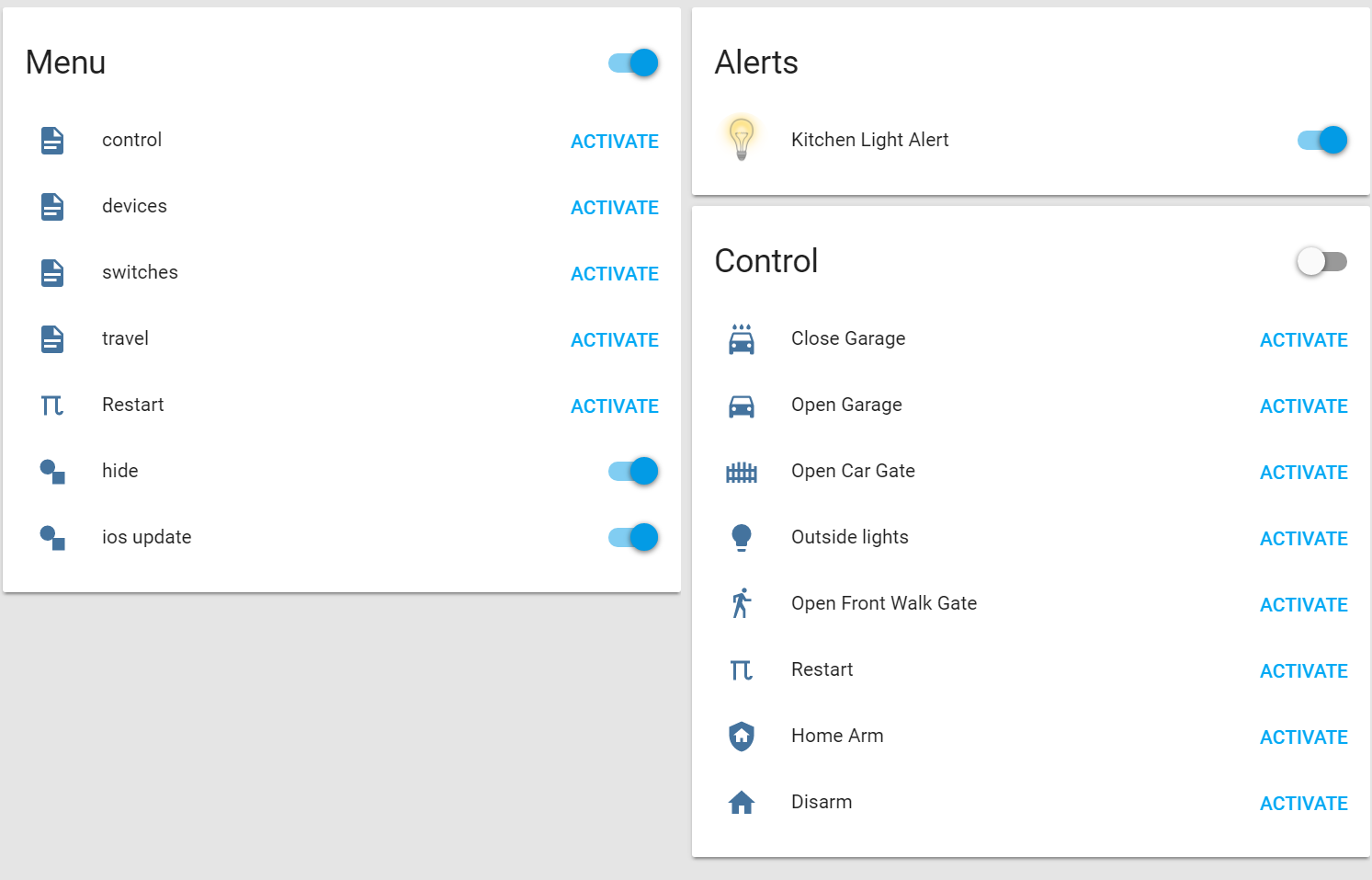

I have three groups
Kitchen light Alert group with only kitchen light in it
Alert group with Kitchen light Alert group
Switches with Kitchen light switch in it
This screen shot has alert group without switch group and without the Kitchen light Alert group
[image]

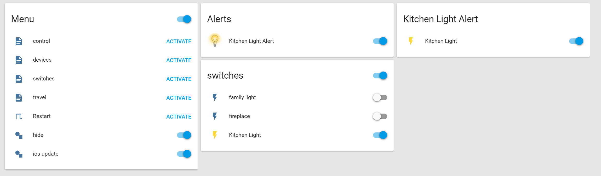

but when i add the switch group, the Kitchen light Alert group appears although its not included in this view.
[image]
