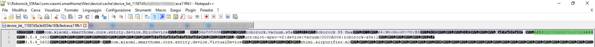

Hi, I wanted to write my experience to find the token in the mi home app. I tried following the guide with bluestacks but the db did not have the token inside, not even encrypted. Then I copied the whole com.xiaomi.smarthome folder after having always rooted on bluestacks and I found the token inside the device_list _… file which is located in the \ com.xiaomi.smarthome \ files \ device \ cache.
token is highlighted in green to the right in the image.
