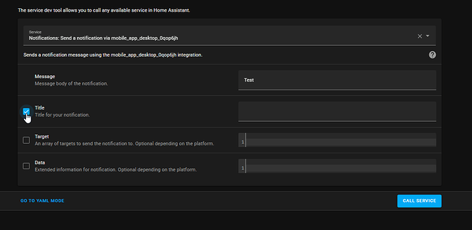

Try Notification service
service: notify.mobile_app_axlt2801
  message: test
  title: test

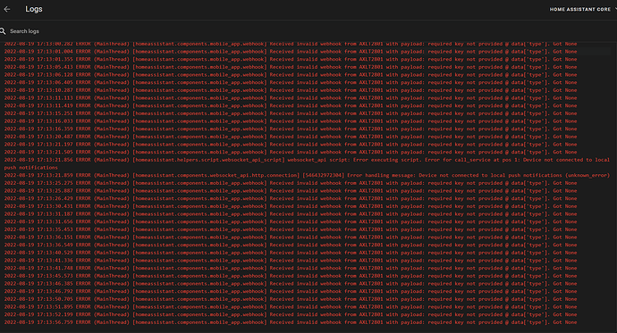

I still get the same error message when I try notification on the latest version.
Nothing in the HA_desktop logs but I see this in HA logs:
