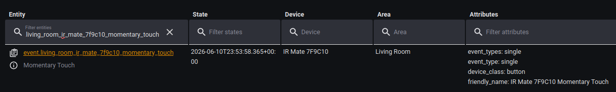

It creates an event entity that HA can use in State triggers and conditions. The on_event portion at the bottom is an automation that posts a message to the device's log when the event is triggered.
That is what instantiates the actual capacitive touch sensor, it tells the micro-controller that it needs to listen to that pin and how to handle what it "hears".
Is that the esphome.remote_received event?
No, esphome.remote_received is not an entity... that is the result of a Home Assistant event action which posts an event to HA's Event bus. These can also be used to trigger automations, but the method is a little more fiddly.

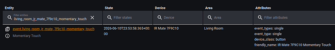

The section JohnyB asked about creates an entity in HA with the domain event. Here's what one of mine looks like:
The repetitive terminology is a little confusing... event entities were created to give certain (basically-stateless) events a state so that State triggers and Condition could be used for them. They are mostly used for momentary button press events, especially where there might be different press types like single-press, double-press, hold, etc.

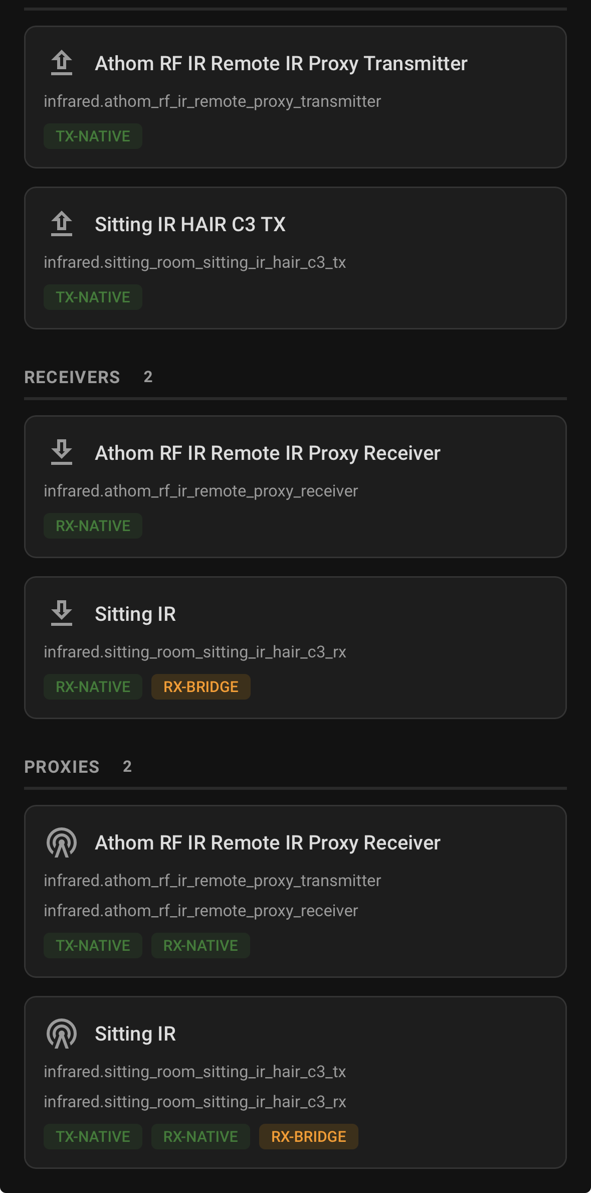

I am also having problems with rxbridge on a new Athom AR01V3. I can see the ir signal in the logs but its not working on the sniffer. And rxbridge is not showing on the ui.
I have used your code for the Athom.
Hair Version 0.4.0
Can I see the yaml you have for the Athom?
