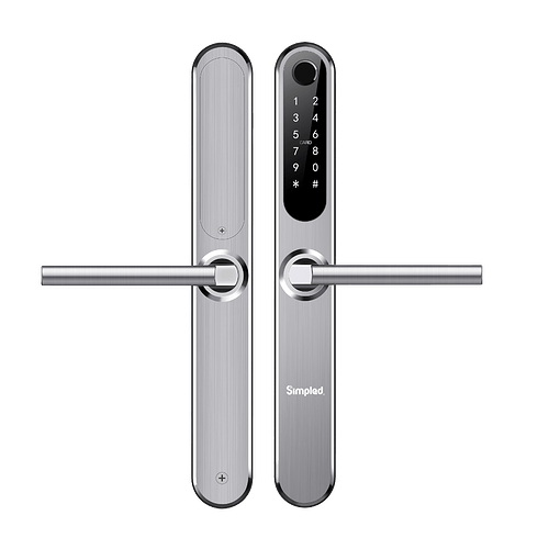

Moving forward, i have been looking at the Simpled EF range lock, which is ttlock and is know to work with Home Assistant.
Has anyone got one of these and can confirm it operates as my first post requests.
At around £200 it is obviously more pricy than the Aliexpress pptions but has not reached the silly price range.
