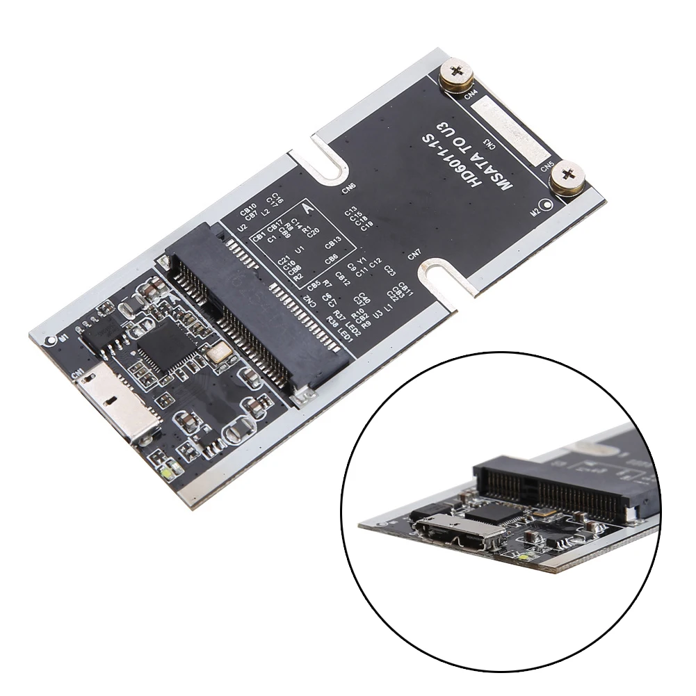

this works perfect!
US $3.07 22%OFF | 6Gbs Converter Adapter Card Mini USB mSATA SSD to USB 3.0 Super Speed Converter SSD Adapter Card
