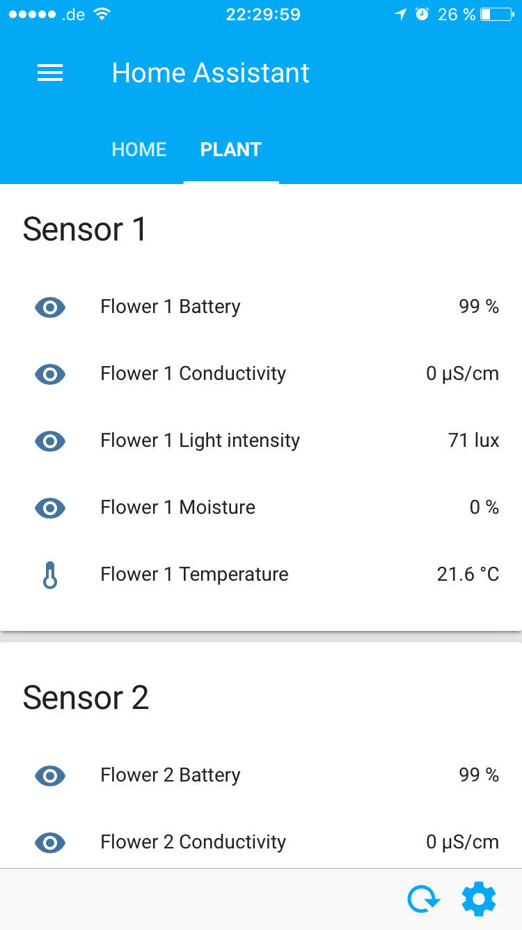

Hass.io Xiaomi Sensor show nothing

Yes i understand it and you did it man :stuck_out_tongue_winking_eye: You are my man after the days hard work with me :joy: Sorry for this an thanks vor your help and your patience.
Now i try how i can connect to the hass.io over the mobile network .
