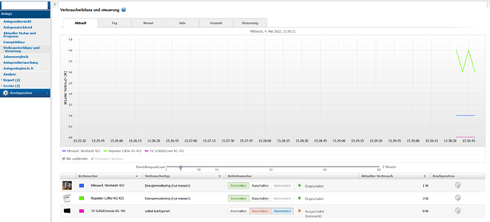

Another question: could I also display the current and total daily consumption of my consumers?
Noch eine Frage: Ob ich den aktuellen und den gesamten Tagesverbrach meiner Verbraucher auch anzeigen lassen könnte?

Could you describe with more details what you mean by “consumption values”? Do you expect something that your SMA is aware ? Or lookink for a way to capture this in your home (fridge, oven, …) ? I am not sure I correctly understand what you try to achieve/collect.
Achso Sorry.
Ich habe Steckdosen von SMA die Steuern und messen können. Im Sunnyportal findet man die Werte unter Verbraucher.
Gruß Werner
I see. This is likely possible but requires some investigation to discover the APIs to retrieve these. This would require “development skills”. There is a tool called “Fiddler” allowing to capture the dialog between a browser & SMA allowing to identify the API calls the webpage is doing. Then these calls can be repeated using Python code (running under Appdaemon4).
Not sure I can help more on that one.
Ohhh this is getting too technical for me. Perhaps at some point the SMA integration will be better. Until then, I’ll use the above variant.

It looks like there is a pop-up or something like that after the log-on. The code does not cover this situation. If confirmed, it should be there only for a couple of days. Can you confirm this pop-up ?
Thank you for helping me.
No I can’t see a popup. I checked Homeassistant and sunnyportal.com.
The error is not due to the update as assumed. I used an old backup, the error is there too.
Where do I have to look for the popup?
Greeting Werner
OK. The code is making an API call and expect to receive a JSON structure in return. This is the expected behavior. Reality is that we receive a HTML page making impossible to load this as a JSON.
I checked on my side and I still receive the expected JSON format.
Not sure I understand why suddenly you receive HTML.
